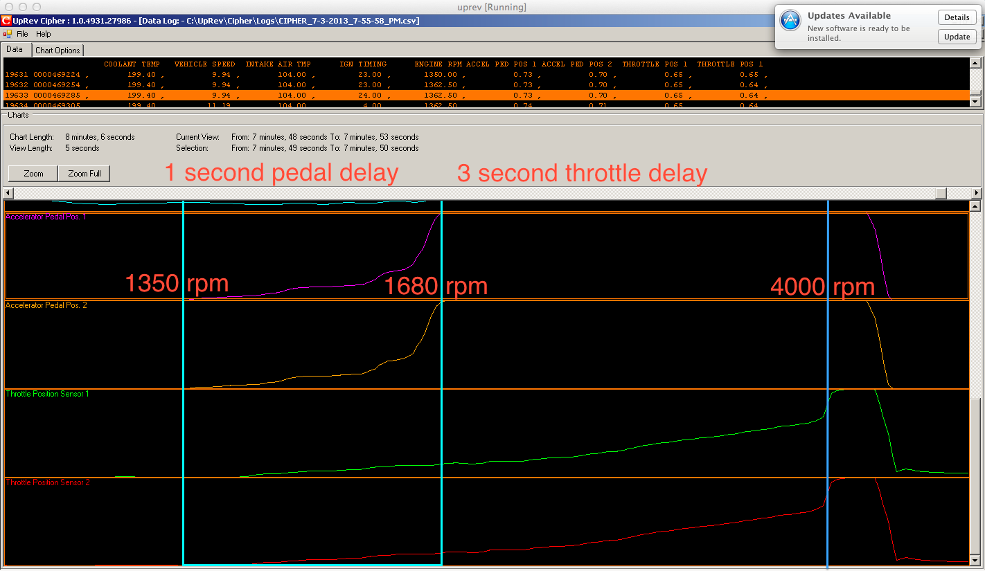

The VHR has issues with throttle lag, pedal position can be maxed but the ECU slowly ramps up the throttle. This isn't an issue on DE and HR. It's a significant amount of lag, 2-3 seconds, or a span of about 2000rpm mostly when going WOT from slower speeds.

Ummm...what? LOL. 2 to 3 seconds??? Suddenly a 13.1 quarter car (some guys on the 370 site have high 12's stock) and under 5 seconds to 60 takes two to three seconds for...what exacly? lol
Look at accelerator pedal position, then look at TPS.
Any other questions?
I do know what the f*ck I'm talking about. You said your old 350Z feels stronger off the line than the 370Z, well here's the reason it feels that way. From 1680rpm the pedal is floored, and 30mph doesn't occur until around 3500rpm, but TPS doesn't max out until ~4000rpm.

Ok, Im not sure how to read this graph. Help me out, spell it out to me, please. When you say "3 second delay", wtf does that mean? Are you referring to a 3 second....what? Im lost.LOL.

I really can't imagine my throttle is on 3 second delay.
I find that completely wrong. maybe half a second tops. Everybody would notice a 3 second delay really bad.
I would say in my experience MB has the biggest delays on their throttle and even they are not 3 seconds.
