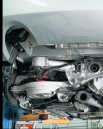

Originally Posted by JRKnox350z
how about chains at each of these two circles?
Those are lift points. There's nothing there to put the chain through.
However, there is a tie down ring on the left side of the underbody behind the tire. You can see it in the middle of this picture at the extreme left edge.
I'd be inclined to get some extra tire nets to secure the rear of the car.
