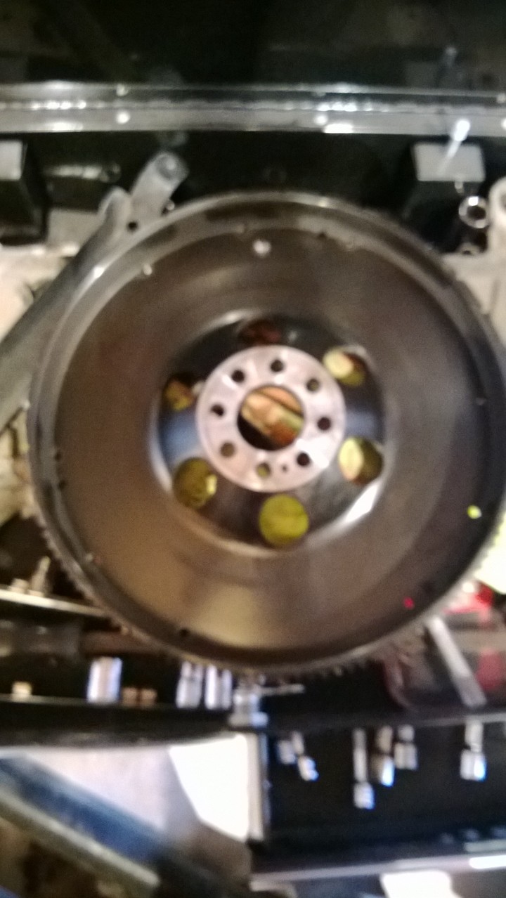

Anywho, I am not going to go through the entire clutch install because that has been covered. I will say that this is the easiest to remove transmission that I have ever worked on. What I really want to point out though, is that our cars have a sensor similar to a crank position sensor that reads off the flywheel. I've seen that many aftermarket flywheels have the timing indicator hole on the front and the back of the flywheel... The competition did not. When I installed the flywheel the first time, I wasn't paying close enough attention and misaligned the timing hole. This caused the timing to be over advanced and threw a check engine light, codes P0011 and P0012 (Camshaft Position Sensor banks 1 and 2 timing over advanced). At first I thought it was because one of my cam sensors was pssng oil. I fixed that, cleared the codes and it was fine for about 5 miles. At this point I realized what had probably happened.
After dropping the transmission for a second time, I got it lined up correctly and now it runs great. The clutch has a stock pedal feel but grabs much harder and you can definitely feel the difference that the lightweight flywheel makes. I would highly reccomend this setup for the price, totally worth the $705 rather than spending almost $1k on a comparable ACT, Clutchmasters or JWT setup. (Not that I'm bashing on JWT, he makes great products and I also highly reccomend JWT, however, for the price I had to go with this)
I have included a picture of the backside of the Competition flywheel, the timing indicator is the smaller hole between the regular flywheel bolt holes. There is a similar hole on the engine side that it is supposed to match up to. If it does not get matched up correctly, you will throw codes P0011 and P0012.
