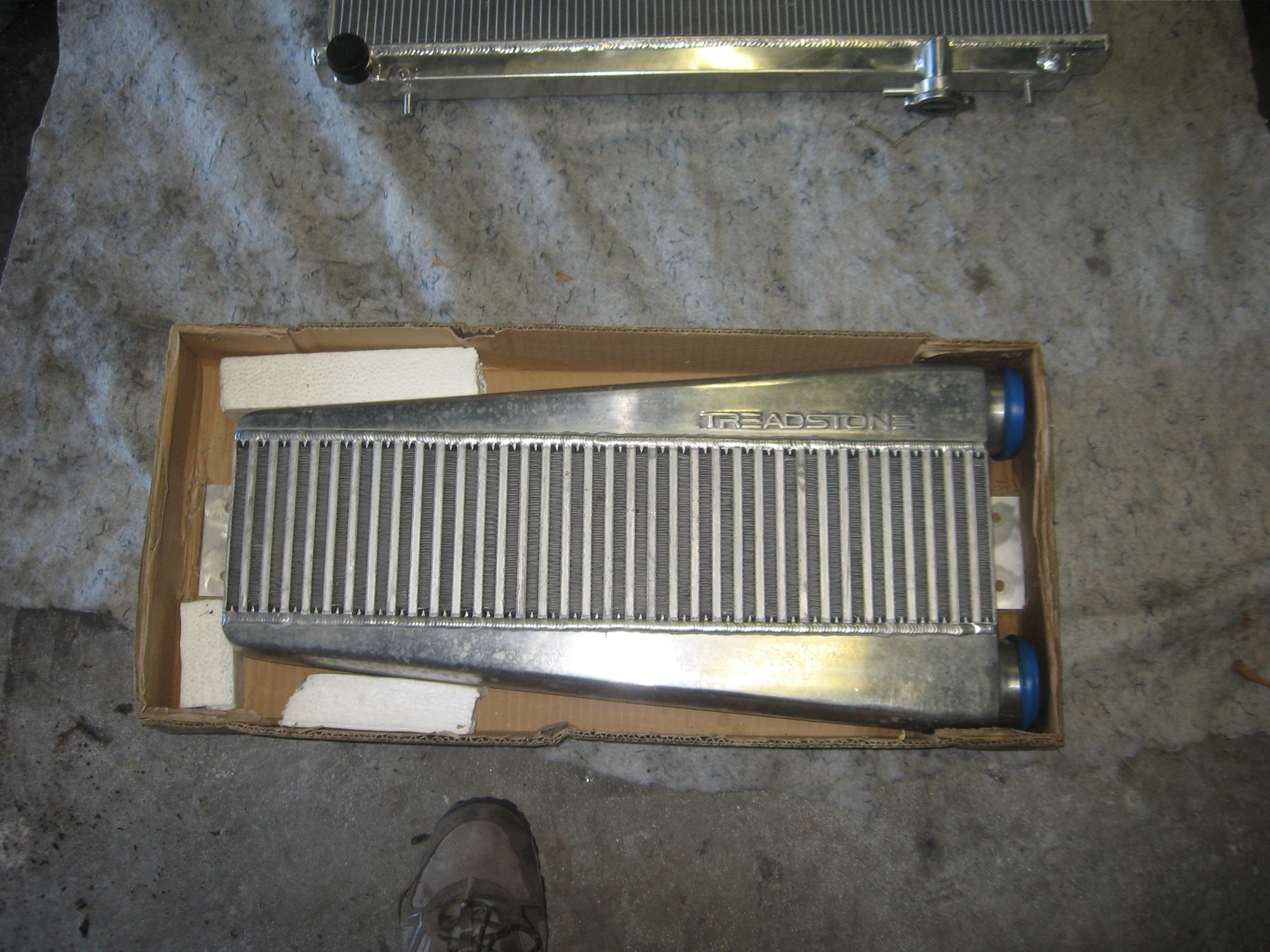

Well some of the things that aren't in the pics are the UPREV tuner, B&M shifter,fluidampr ,anodized pulleys.The paint should be arriving on Tuesday it's from the House of Kolor.Im going to do a black over blue two tone.
A short list of some of the things I'm planning on getting .
For the motor: J&E pistons ,Eagle rods,rev up oil pump,timing chain,Arp studs,kind of going back and forth on what head gaskets to get OE or cosworth,looking for suggestions on what fuel injectors to get?it will have a return fuel system.
turbo: I need to get the other side tank for the cooler for the twin set up,Tail 50mm Bov,all the pieces for the tubing ,header wrap and a UP REV maf senior .
drive line : Competition light weight flywheel ,doing research on what clutch to run,It is a 6 speed ,not really plaining on doing anything to the rear end ,full white line bushing kit,upgrade the brakes .
As for the interior just your normal gage setup,I have the black leather seats now. I also need a new top it has a rip on the pass side rear window
Plaining to build it for 600 rwhp but hope to be in the 475-525 range.Im open to any in put on thing that I have done or should change.95 % of the work will be done by me !bordering the block at work, making the oil pan and plume spacer. The only things I can't do are balance the rod/ crank assembly ,align hone the mains and the cylinders but that is cheap.

are you going to be able to fit the new cooler behind your stock front bumper? If not I'll buy the bumper off you to help make up for some of the money you're dropping into this
give me a week or two to do some trial fitting of a few things ,it's yours if I don't like the way things fit shoot me any offer

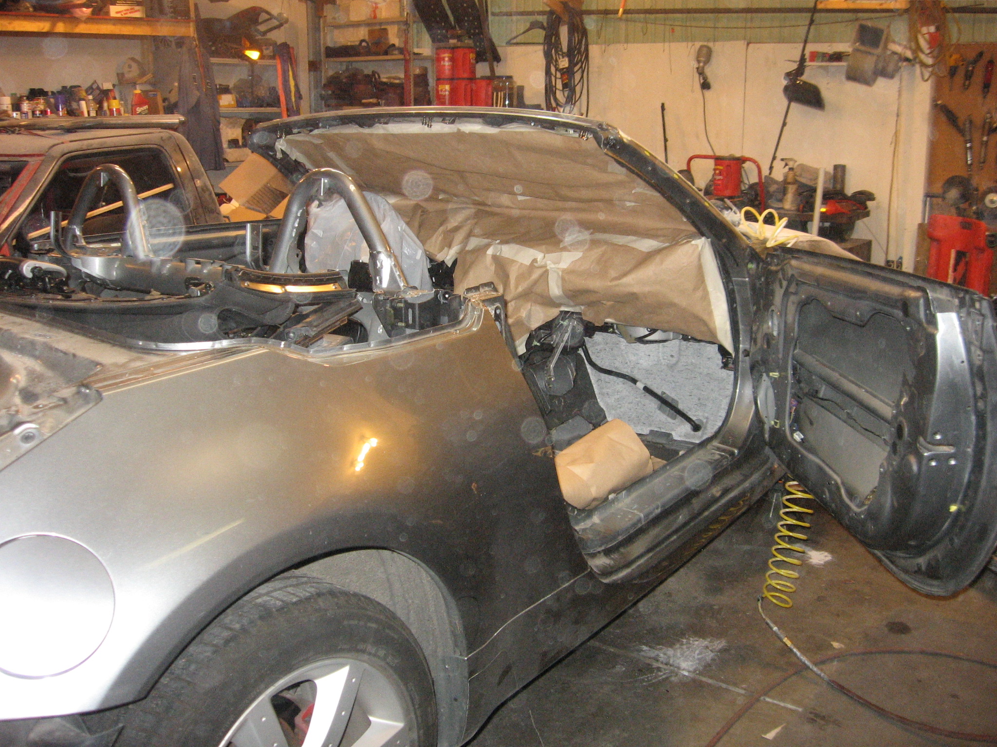

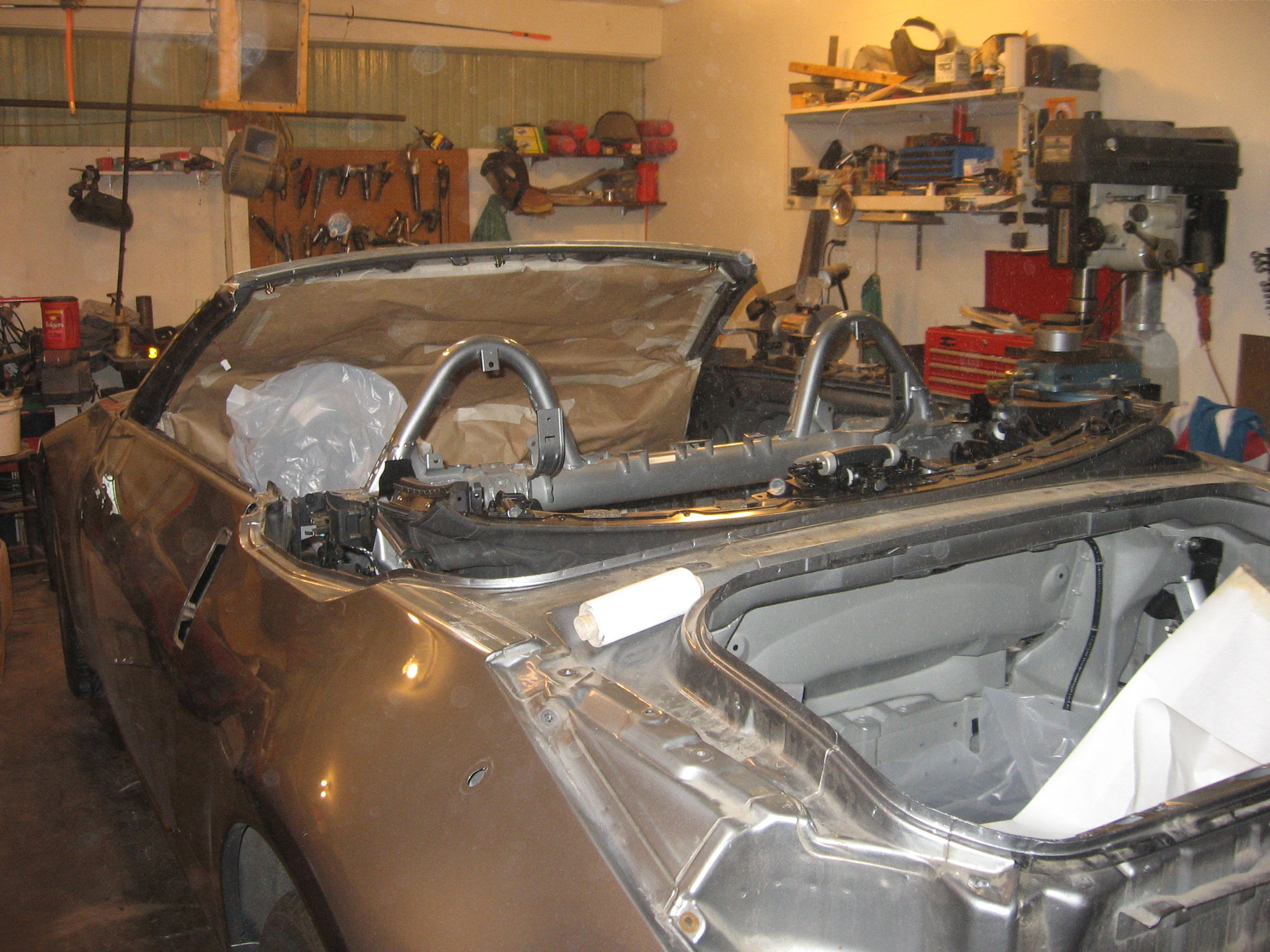

So I didn't get a ton done in the last two day but :
Fixed the one rust spot in the rear quarter ,not to bad for a car 10 years old in Michigan.
Welded the hole for the antenna in ,going to relocate it.

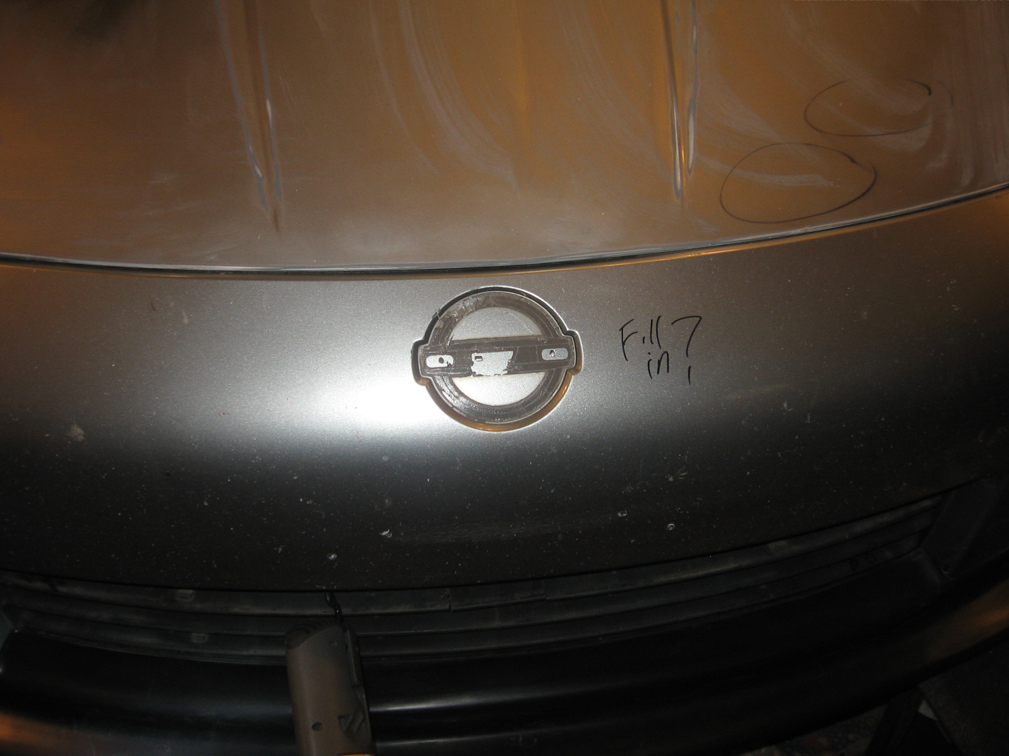

Front chin lip came in Monday spent about 2 hours getting it to fit the way I wanted it to.Used a heat gun and about 6 different welding clamps and a gallon or 2 of ice water to get the curve to fit right. Then my mind kind of got away from me.I need your guys opinion on 3 things.

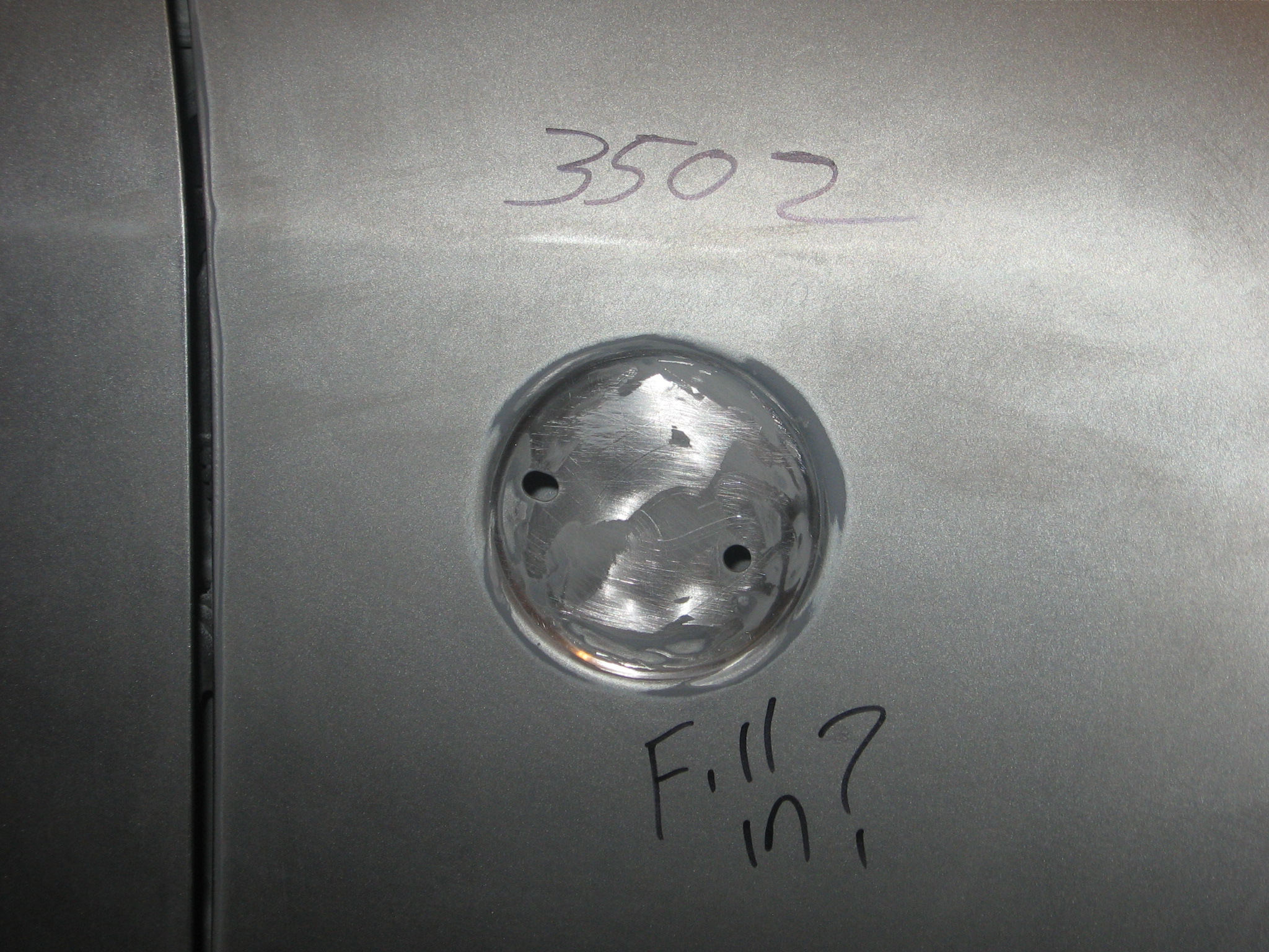

1: I'm thinking of filling in the pocket on top of the nose piece ?
2: thinking about filling in the pockets on the side of the front fenders and taking the 350z emblems and having them hydro dipped in fake carbon fiber and putting then just above the old Z symbol?
3n the front nose piece taking out the orange reflector's and opening up the holes about 3/4 of an inch and getting some screen to cover the holes. and putting the oil cooler behind the passenger side and the power steering cooler behind the driver side.I should be able to heat it up enough and bet them in to make a little bit of a air duct.I don't drive in stop in-go traffic much if at all with this car,less than 40 miles a week.

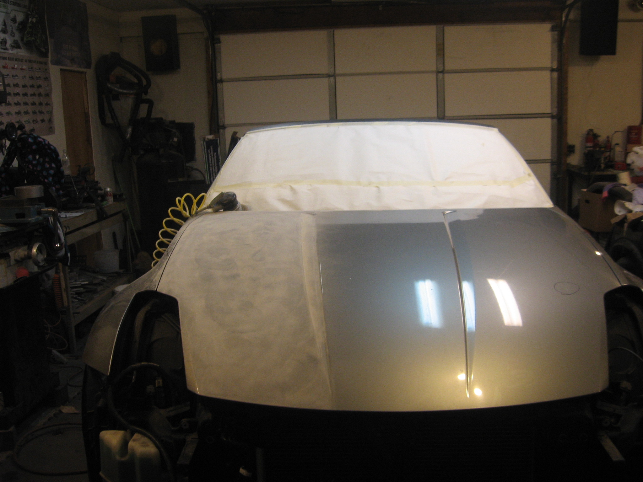

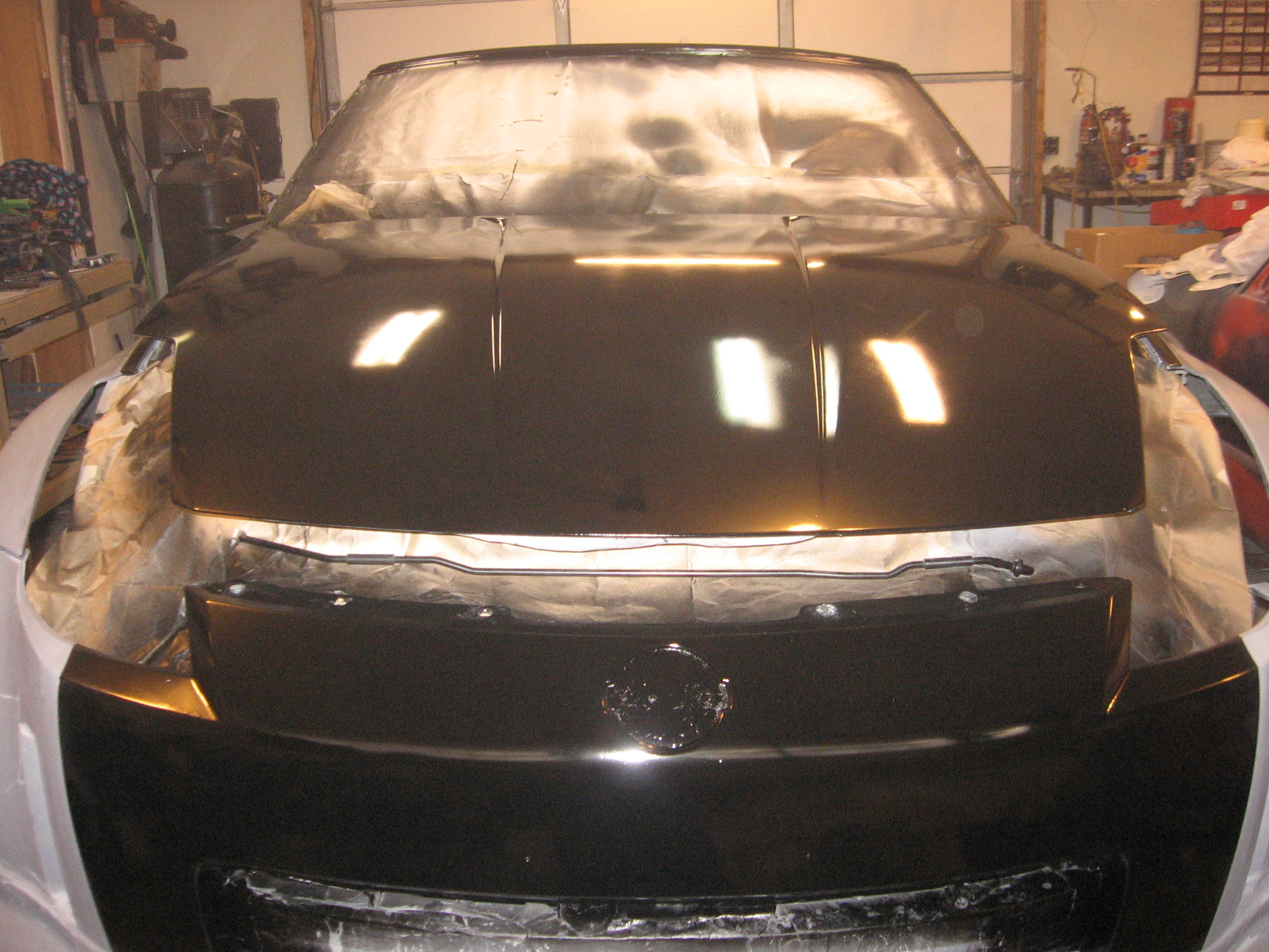

Got the hood,fenders tail section and side skirts primed and sealed this week.Waiting on the add on side skirt wings and the rear spoiler.Hopefully the weather will corporate this week and I can get it painted before others to cold ,its been in the mid/low 50,s all week to cold to paint,cant get a good flow out.Spent most of Saturday mixing paint to get the color blue I like might add a touch more green .For the couple of members that were interested Thanks

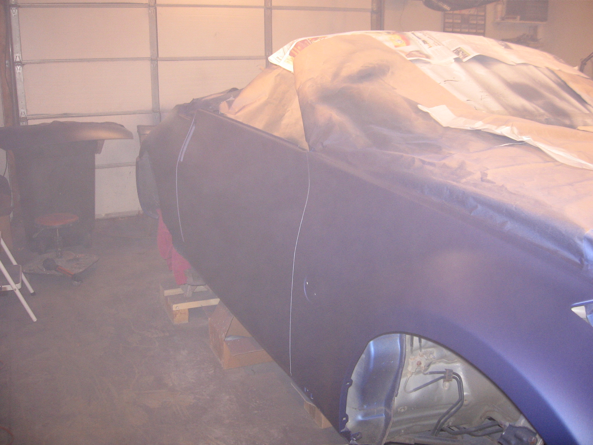

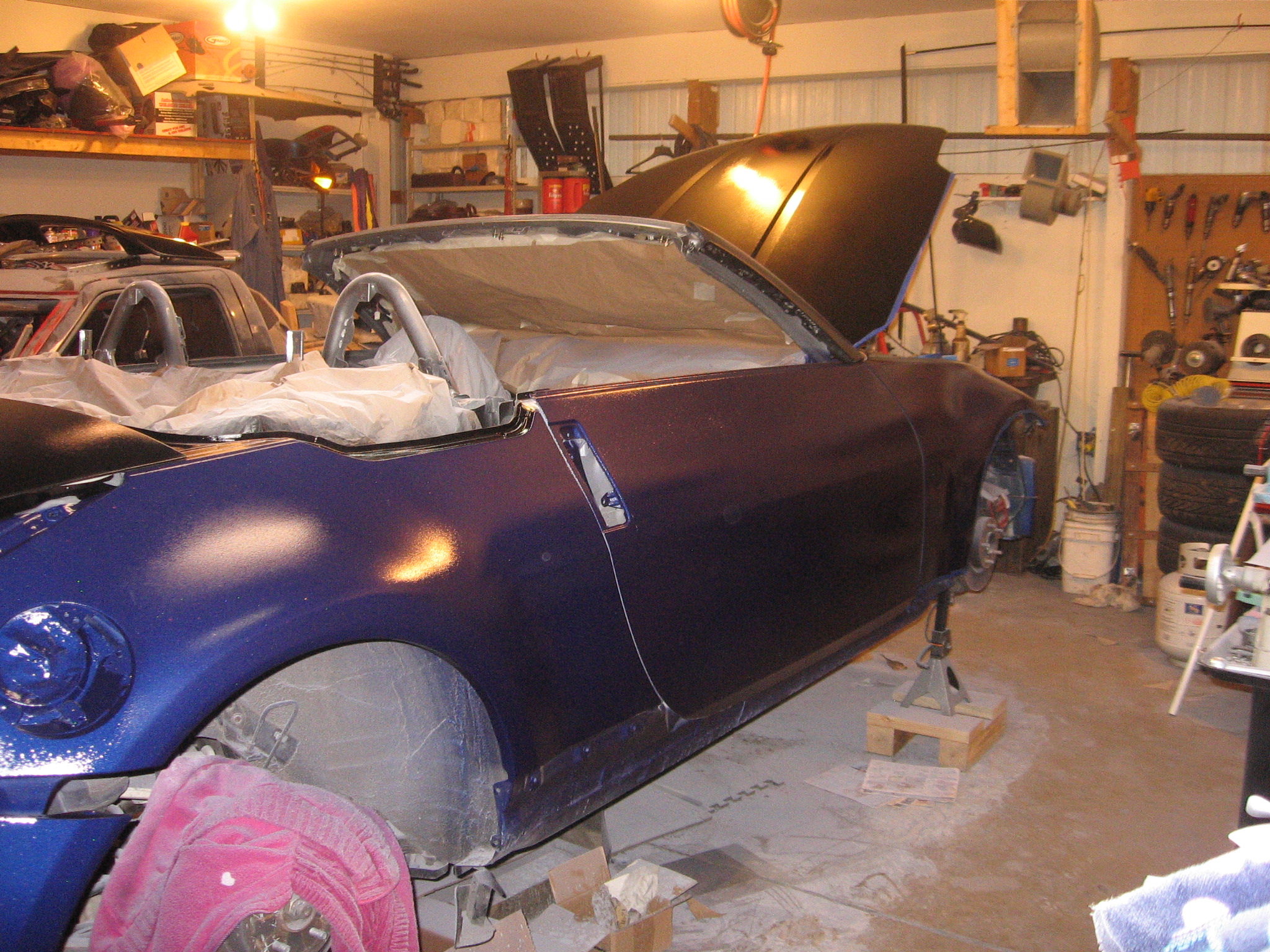

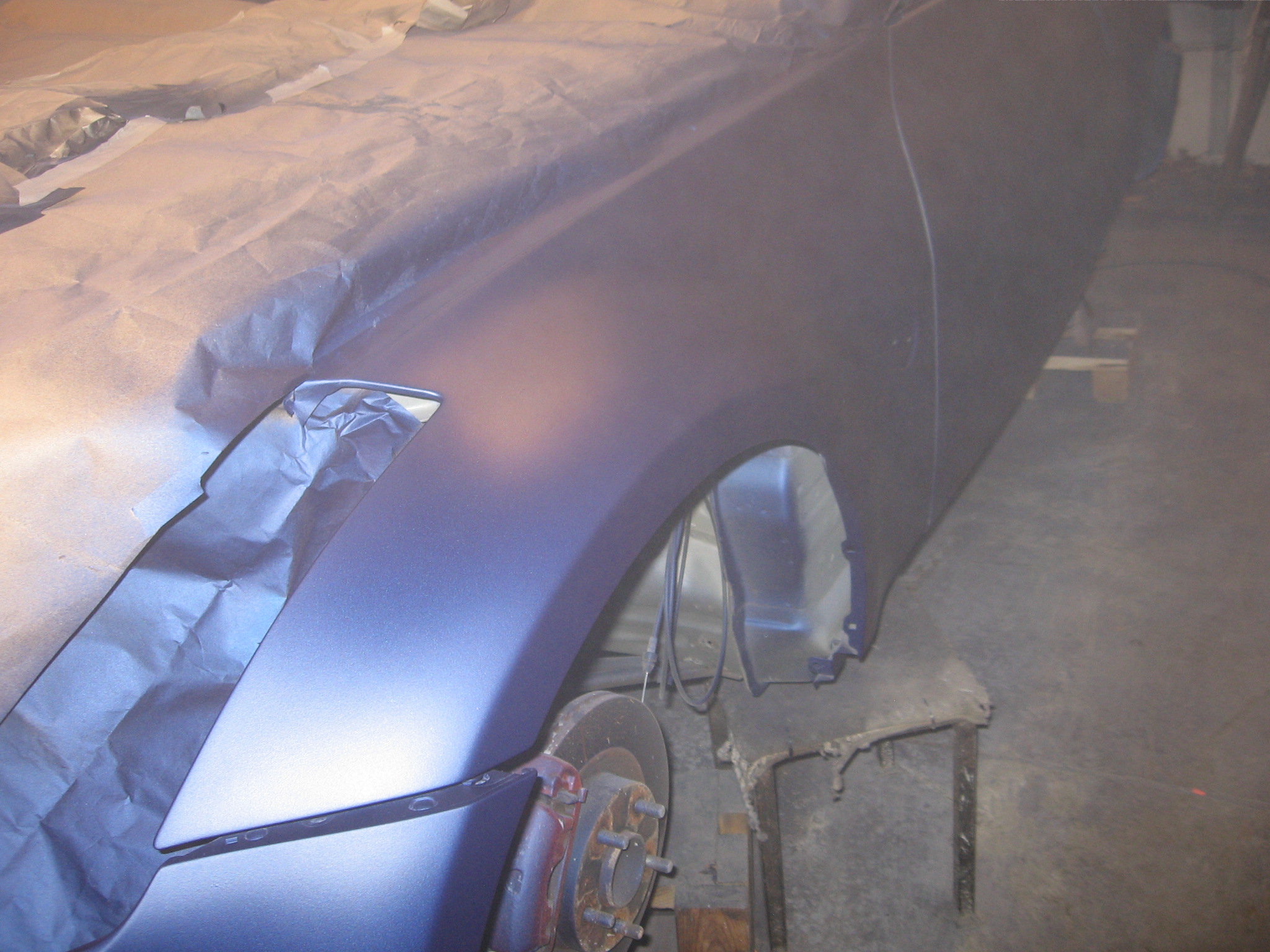

Well what has been a really crappy month for my family is finally over (neighbor next door passed my kids looked at her like she was a grand mother,the fallowing week my mother in law passed away and the day after her funeral my uncle died )So I finally got the car painted this weekend not sure why it is purple in the picts but it is dark blue out in the sun light.it needs to be color sanded yet,I'll do that later still need to paint the inner fenders and the engine bay after I pull the motor this weekend. The only thing I can think of is when I put the second coat of clear on I added some purple kicker to the clear to bring out the blue more and under florescent lights it looks purple if it is overcast out it looks like its Yamaha blue
