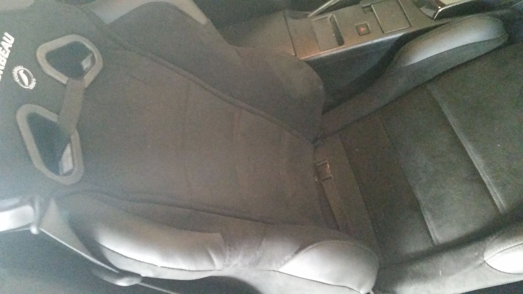

Sorry for the late response, came home last night and just crashed out. These were taken this morning after parking so excuse me if they're a bit blurred. Corbeau sells seat brackets specifically for the 350Z at an additional price and I've included the link below. However, I'd caution you to have a dremel on hand after you remove the old seats.
On the driver's side, there's a small metal spike welded to the floor that serves like a guide or something for the OEM 350Z brackets. The replacements from Corbeau won't clear that and you'll need to cut or file it down to ensure a proper fitment.
Hope this helps?
Seat brackets:
http://corbeau.com/nissan-350z-03-08-seat-brackets.html
** and before anyone asks, those straps on the passenger's seat are attached to a small bag behind the seat for storing crap. Our OEM seats come with some pretty convenient side pockets on the bottom for pens, change, etc.. and the new seats have nothing attached on the sides or rear for stashing small random items.

Nice seats. Do they adjust and, if so, how?
