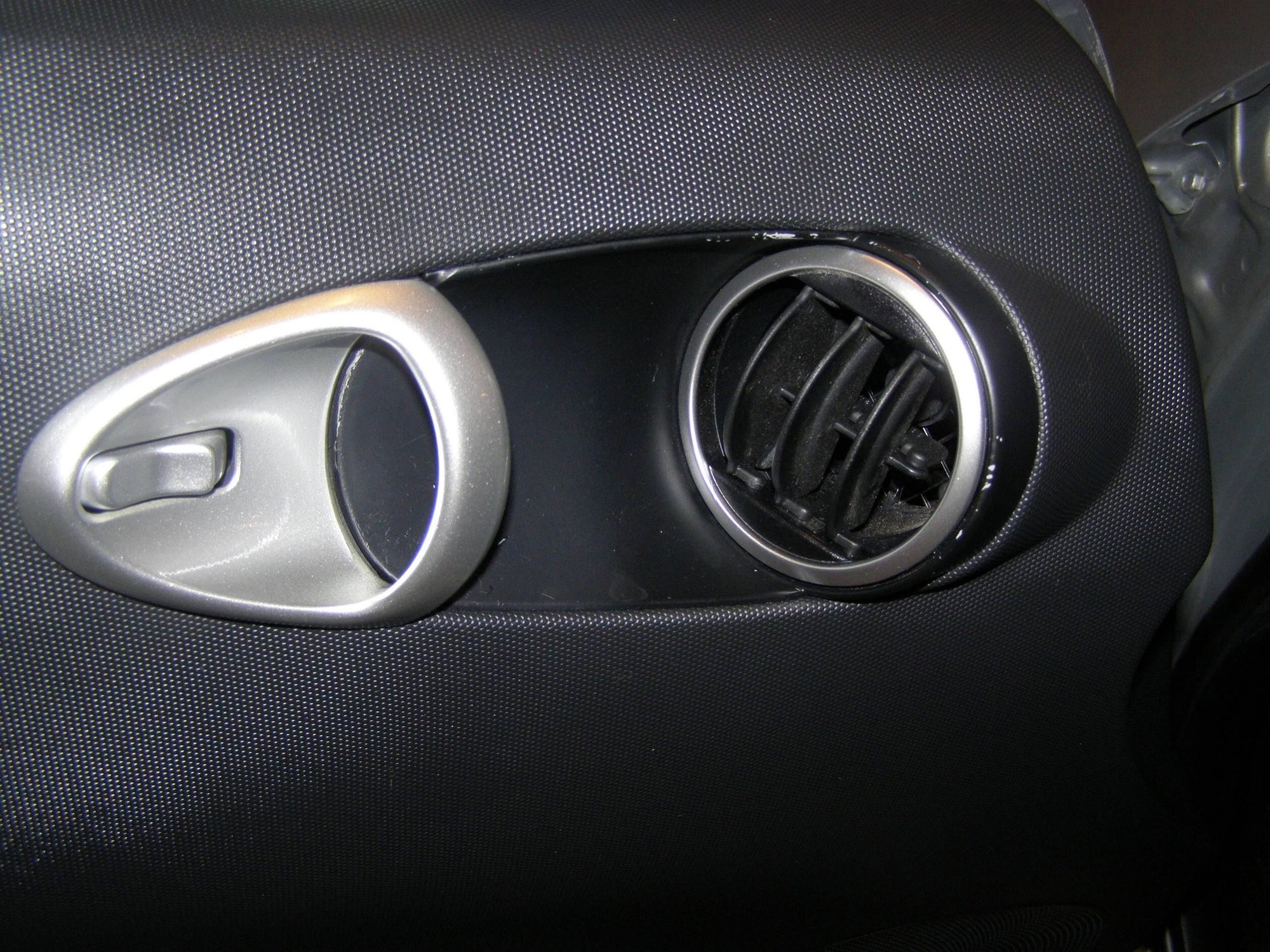

Can't seem to find a way to remove this interior part on the doors.

Its part of the door panel. Pull the handle should be a little plastic piece under it remove that under that is a 10 mm bolt remove that gotta unhook the door handle wires. Remive all clips hole door panel should come off once the arm rests and stuff are removed. Ill find you a link..
^^^^ This.
The door handle assembly is removed from the back.
As dboyzalter said, remove the plastic panel behind latch and the bolt behind.
Pry up the control panel on the armrest to reveal the other bolts you need to remove, disconnect window controls, then pry around bottom of door to free up the panel and lift off.
Sadly, I can do this in under five minutes now....
Helpful hint: use plastic panel removers to avoid marring the interior which remarkably scratches very easy.

Awesome it did the trick appreciate it bud!
