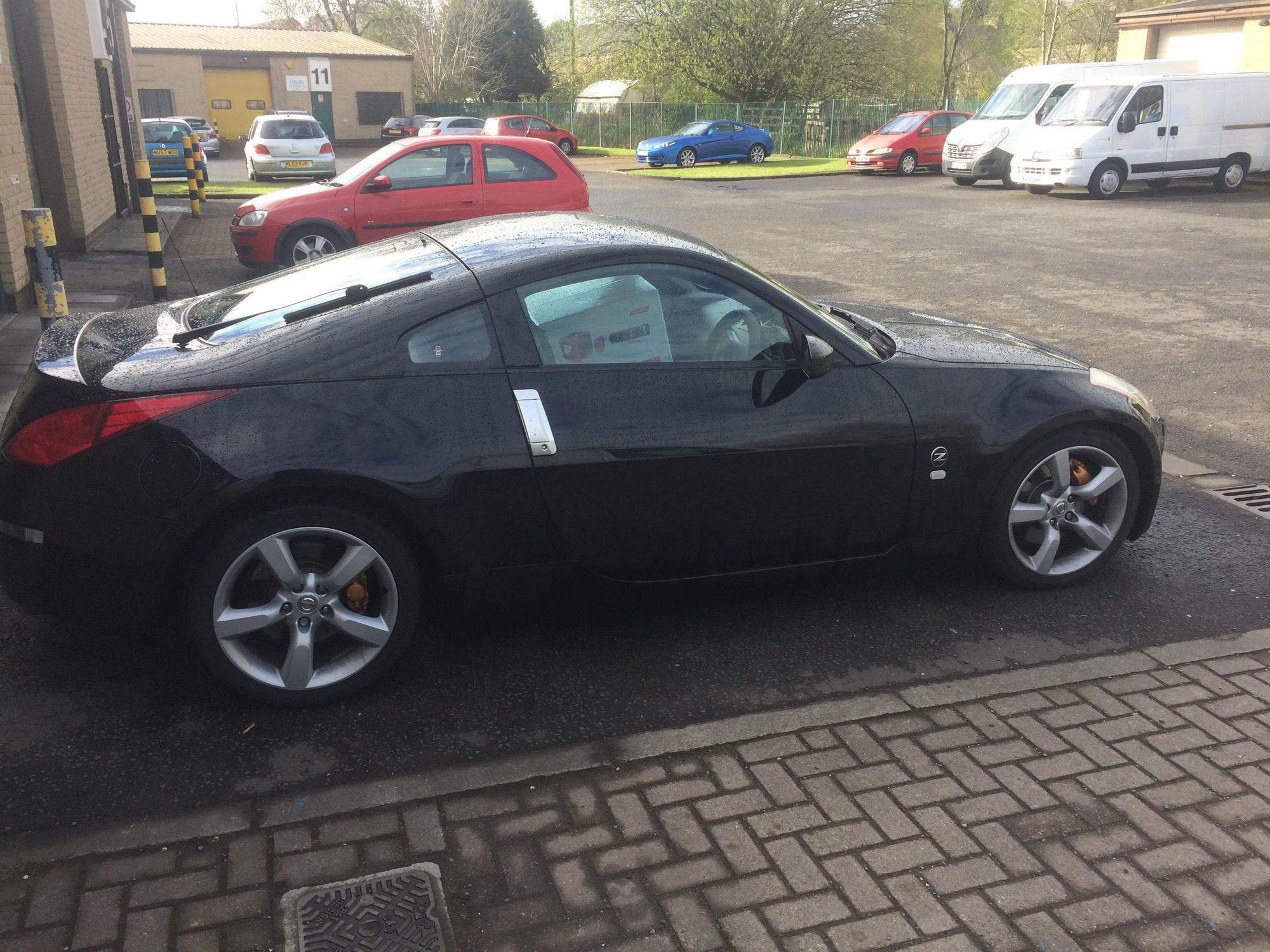

Hey Fudge, take a photo of the GT4 and post it. I'd love to see the thing - I didn't know that there was a GT4 version of the 350Z until yours popped up.

Heres the car
It features the "Rev up" engine, not sure about the transmission. I believe the car has some extra badging which is located in the door wells but i am not sure if other 350z have those.

Wow, that's the first time I've ever seen a GT4 plague. Let alone a "GT4" version, I thought you were referring to something like a 35th Anniversary.
