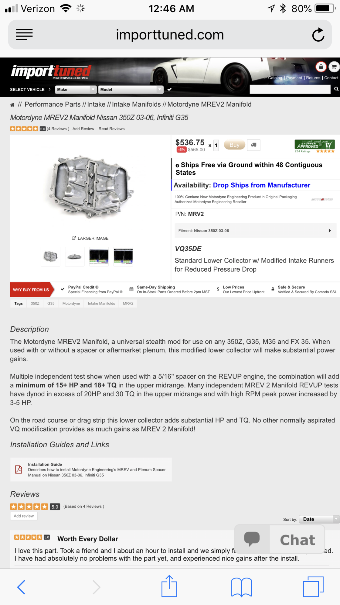

So after the few days of owning the car. Ive noticed it’s got great power and I love how it feels. But naturally a car guy always wants more. So, what I’ve been searching is this;
A 5/16 plenum spacer, and this intake manifold coupled with probably an exhaust (Invidia N1), a lower intake from Motordyne (I think it’s from them I may be incorrect), an oil catch can, and possibly high flow cats, a tune and a throttle body spacer, would grant me more useable mid range power?
I have been watching “AnthonyJ350” on YouTube and some other 350z guy channels to learn what and what not to do. From the experience here, what do you all think of this?
I don’t want anything to dramatic because I do want to make it a nice second daily driver that’s got some power. Budget isn’t the biggest but isn’t the smallest. Any tips please do share.
Thanks!

Unless you have a Rev up, don’t bother with the MREV2 and use the money saved for a tune
Old Apr 28, 2018 | 11:25 PM
Haymore1965's Avatar
Haymore1965
Joined: Apr 2018
Posts: 16
From: Kansas
Motor redline is at 7k. That should be revul yeah?

Aloha! I installed the 5/16” Motordyne spacer just today and it definitely makes the car quicker. I have a DE motor, I didn’t get the isothermal version- just the plain one- and it’s an easy and effective upgrade. I’ve seen people debating whether it’s worth it and I have no idea why they’d do that: it’s an *obvious* increase in power. I’d guess 8-10 HP up above 4500 or so. Sounds way better too.
There’s a lot of mods you can do to improve the Z, but not any that cost less than $225 that gets you this much improvement...that’s basically the cost of a single nice tire!
The spacer helps but the tune will make the biggest impact...

Best bang for buck NA mods:
Plenum spacer, test pipes, cat back, tune. End of story. I paid an extra ~$3000 for more parts than yielded maybe 20whp.
Focus on suspension. My car changed most with a decent set of shocks and springs as well as full Whiteline bushings. Those make the car a joy to drive on any road.

Get the plenum spacer, OR the kinetix plenum. Not both. Ditch the throttlebody spacer.
Get a tune. Best bang for your buck in noticeable all around gains. Feel free to PM me if you have any questions.
