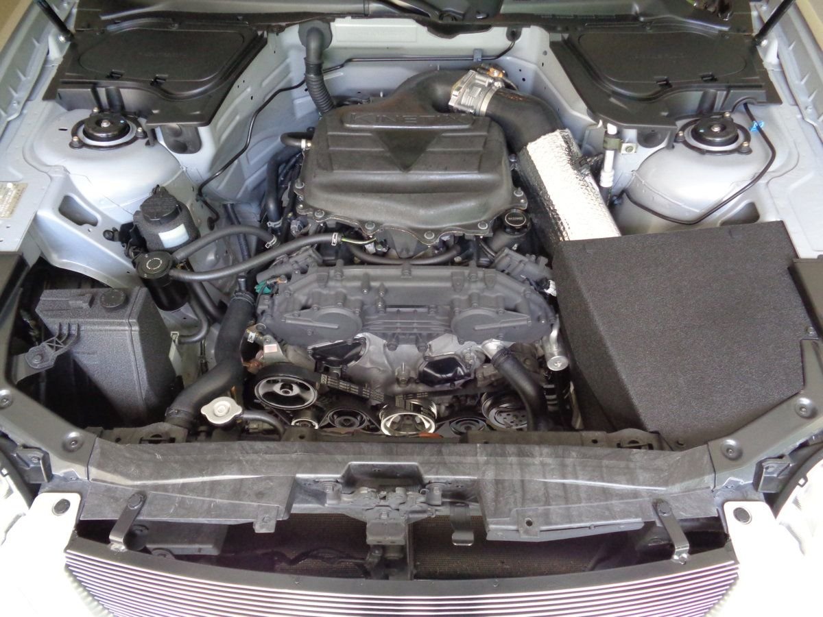

Spectre has plastic bungs, small, med & large that come together for -$10. Corresponding grommets included. I used the medium size and drilled a hole in my diy 4" pipe. Mishi catch can works well. No problems.

From your pics, it looks like you have the catch can on your passenger side valve cover from the PCV valve to the manifold without a breather filter.
Do you also have a catch can from the driver side valve cover to your intake tube? If so, how much (if any) blow by do you collect?
Also, did you get it tuned before or after the catch can install?

Your welcome. The driver side is attached to the intake pipe just like it was stock. I highly doubt there is any correlation regarding the catch can and a tuned ecu via software. You need to be sure air can come into the crank case and exit the crank case.

Initially I had a breather on the pass. side v.c. and a drilled-out pcv but I didn't like the smell inside the cabin w/the heat or a/c on and noticed the mileage went down without any noticeable power gain. Now everything is oem and the baffled c.c. is an extension of the pcv system which catches MOST of the oil. IMO I think it's good that it doesn't catch it all as some oil can get to the tops of the pistons for lubrication. Foreign cars have tight tolerances and I believe manufactures want some oil in the combustion chamber for longevity.
You must've prevented air from getting into and/or out of the crank case.
