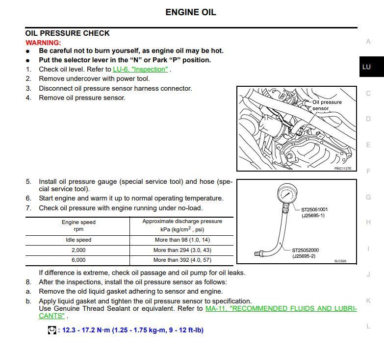

Check your FSM to see what the OP should be at warm idle & 2k RPMs (no load most likely). Then check your OEM gauge readings and use a mechanical gauge in place of the OP sending unit to verify if your OEM gauge is wonky or not.
If it is, new OP sending unit should fix the problem. Maybe replace the gauge. At the very least, you will have isolated any mechanical issues.

From the FSM for '03:
