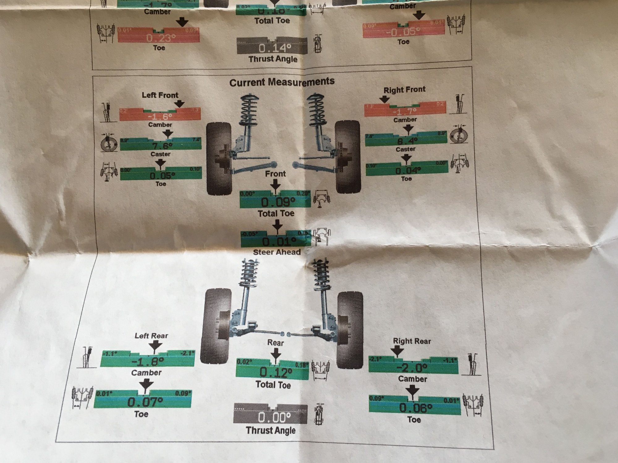

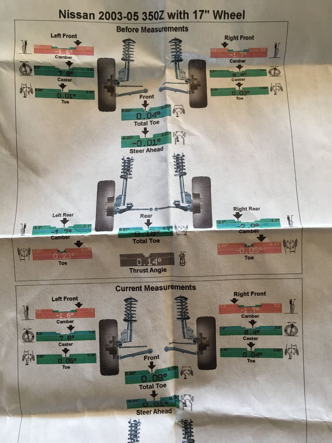

Alignment from shop before and after

Update: Unfortunately, the car still pulls to the right. I went ahead and checked the brakes and calipers again with the basics. Also, the alignment shop went ahead and aligned it to 2006 specs. At this point, I'm probably going to talk with the dealer. Thanks again.
