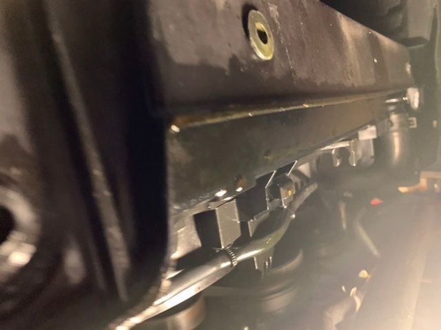

Happy holidays everyone. Just looking for some help. I completed fixing most of the oil leaks. Changed the upper and lower oil pan(pain in the....) but o got it done. But I see oil coming from the radiator channel and electric fNs even though everything else is nice and dry. I have checked everywhere for this leak. It doesn’t make sense to see oil coming from radiator bottom channel. I don’t see oil in radiator. It’s not smoking, I have cleaned it with brake cleaner several times only to find it like this. I thought maybe it’s pressure only when driving so I have it up and jack stands and had someone rev it while I looked around and can’t see oil anywhere. Any thoughts? The next step was to remove electric fans and see what else I can see behind. Thanks

Are you sure it is engine oil?
if so isn't there an oil cooler mounted near the radiator ?

Power steering maybe. What color is it?

It’s not red like the power steering. Plus it’s still full. It’s brown. Are there any oil lines that run under the power steering reservoir? Really not sure where it’s coming.
