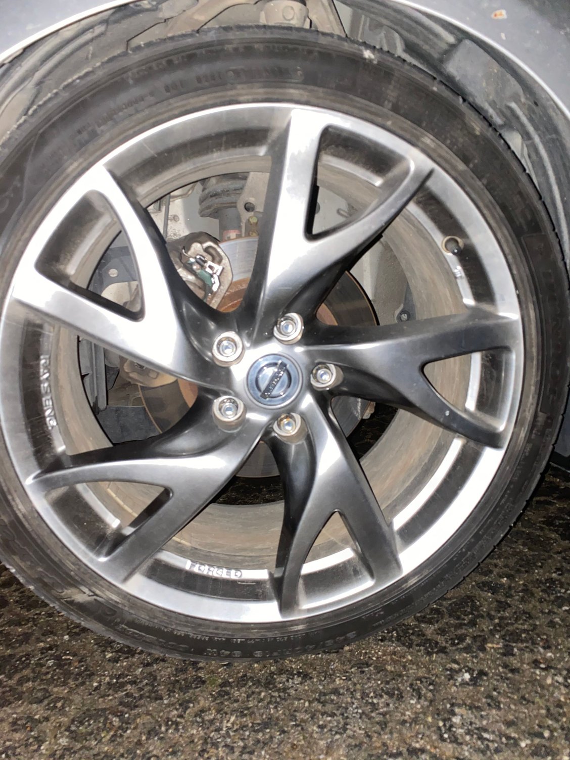

My nephew has a 2003 base model and he bought a set of wheels that were on a 2013 and he already bought spacers but he was told he also needs hub centric rings. I have not been able to check them to see. What else will he need. I think I read on here that he will need the newer lug nuts. Any help is appreciated. I am going to try and add a pic of the wheels. We will see how that goes😆 They are Rays if that helps

Hub rings NOT needed. Whoever told him that was full of sh.... That's an OE Nissan wheel. ALL Nissan wheels are 66.1 center bore for <wait for it> 66.1mm hubs.
Spacers, yes. As you mentioned, already purchased. Just make sure what were purchased are hub centric (66.1mm) and for those Z34 Sport wheels, should be at least 20mm wide (to bring the offset down to a more Z33 friendly +27mm. (Or 25mm wide for a little more flush fit.. Either is fine.)

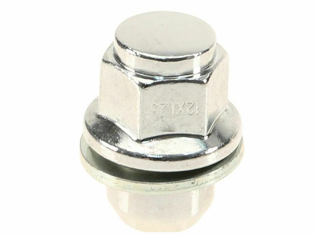

Lug nuts, yes. Must use the shanked 370Z lug nuts. (Below) NEVER mount OE 370Z wheels with lugs from 350Z or any other 60-deg conical lug nuts (AKA "tuner lugs"), the lugs WILL loosen. Not "if", but "when."
