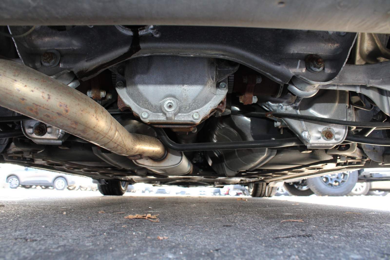

2 different cars. Both 2008. What is the hole in engine bay for and is that level of rust bad ?
Bottom carriage pics are from other car. Is that too much rust ?

Hole is the top of the shock, and tbh never seen rust there before. The underneath isn't bad, depending on where the car grew up

For the bottom carriage pictured vehicle. The rear diff bushing is blown and will need to be replaced, minor and very common, but just another item you can use for price negotiations. If you're concerned about rust, areas to really check would be around the rocker panels, especially around the edges of the front and rear fenders. If there's signs of paint bubbling or scale, I would walk. Take a good look under the front subframe and inspect the chassis braces (both front and rear). The rear W-brace is notorious for rusting away since it's folded/stamped sheet metal. The front components are heavier duty and all are painted from the factory, but if the vehicle saw salted winter roads, the rust can get pretty bad.
From what I can see, this car has minor surface rust which wouldn't make me question it's integrity. It's at a level where it can be treated without breaking the bank. The surface rust around the rear axles and diff output shafts is normal, every Z gets that as Nissan never put a protective coating on those parts.

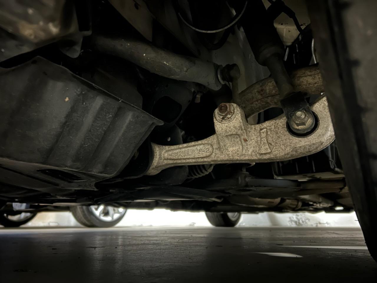

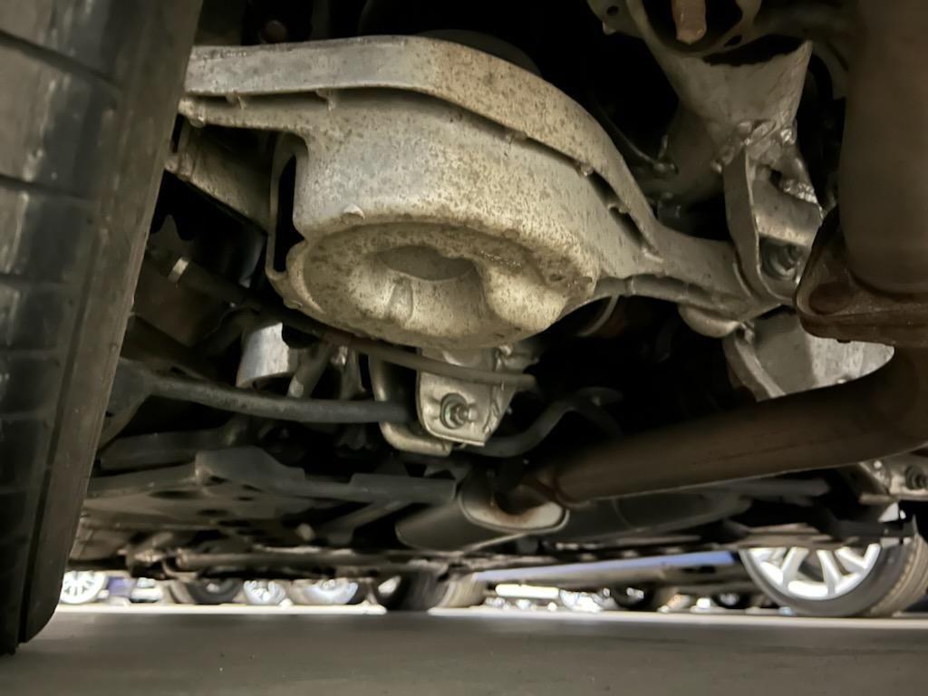

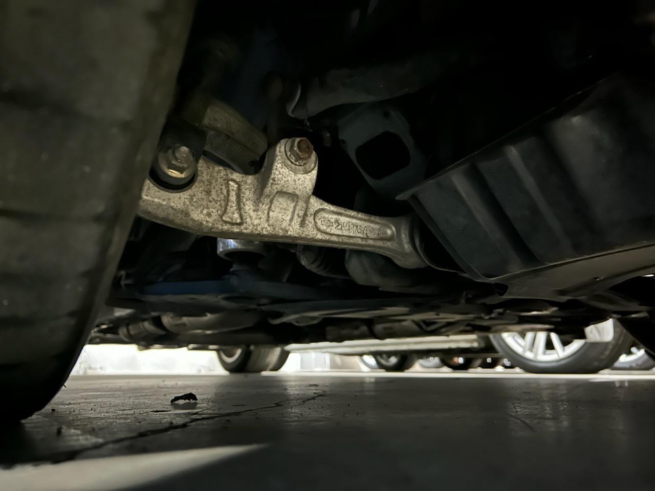

Man you are a Saint. For the undercarriage car I'm getting a prepurchase inspection done tomorrow , but sales guy sent me these pics too . Hard to see but looks decent i think.
They sre both out of state unfortunately ao can't inspect in person and have to rely on PPI sending pics like thet did with the 2008

Icer, good call on diff bushing, I missed that

The additional pictures posted from the dealer don't really say much. Those are all the control arm components, which on Z33s are made from aluminum. So those will never rust, they will get some light surface oxidation, which is evident in the pics. The chassis braces are at the center of the car, they are painted steel, you really won't be able to get good photos of them without putting the vehicle on a lift or jacking it up. The front subframe is also hidden pretty good behind the lower pan cover.
From what I can see, this Z has some oxidation but it doesn't look like grew up with heavy use in the winter on salted roads. But a closer inspection with better lighting on a lift would tell more.
What state(s) do these vehicles reside in?

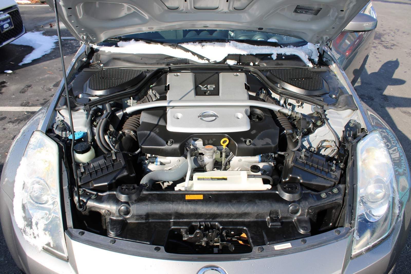

In my first post, the engine bay is from a car in Oregon. The bottom pics are feom a car in Missouri.
My next post with more under car pics are from the Oregon car.
The enginr bay on the Missouri car looks pristine, but the those are the first pics with the rust under the car. I attached pic of interior of both cars. They're both really good inside.
The engine pic is from the Missouri car. So clean.
Missouri car is Base, Oregon car is Touring, $16.5k vs $20k
