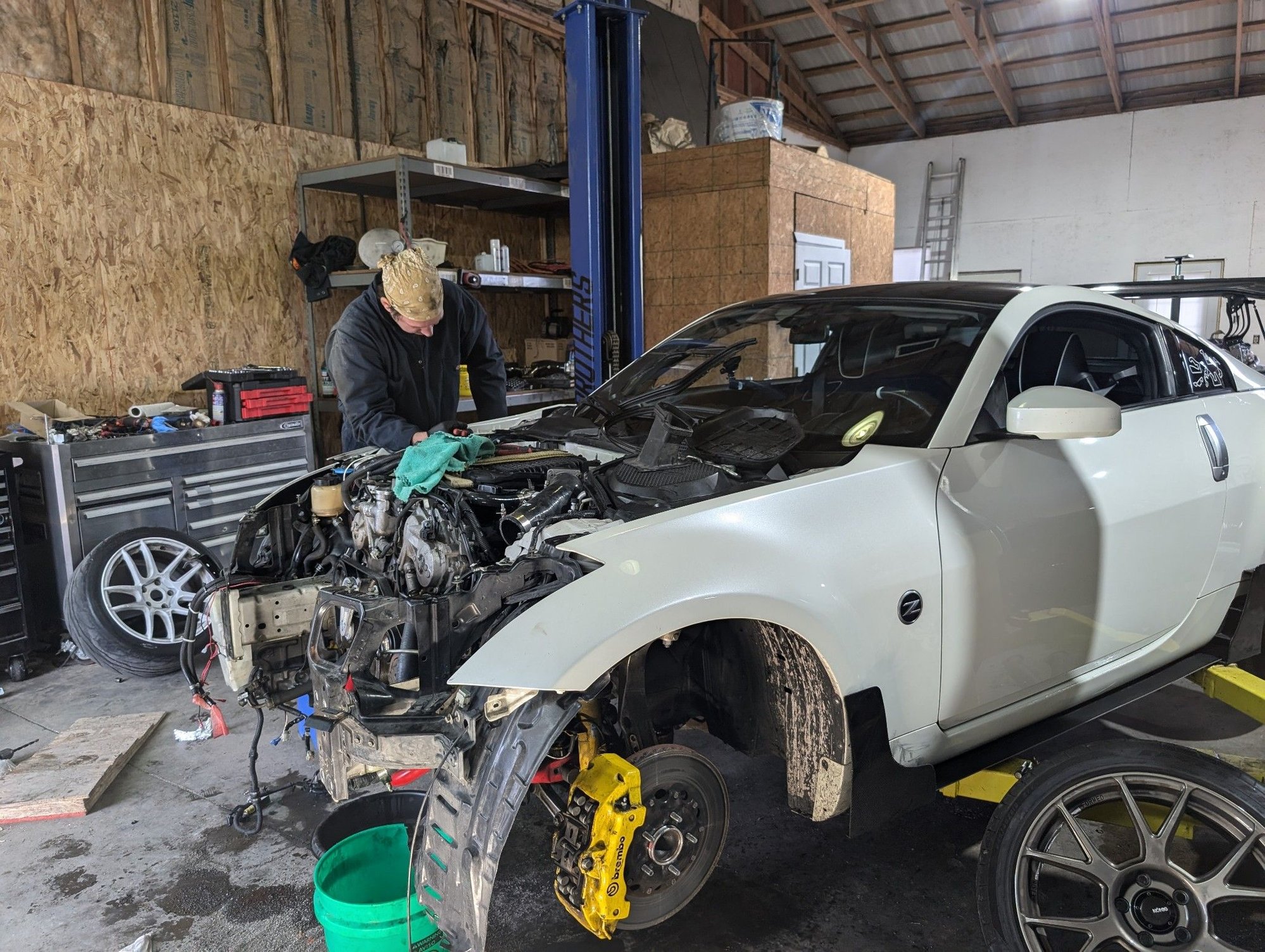

I actually have a new engine. My buddy and I swapped engines. Long story. I'll throw up some pics though just for fun.
