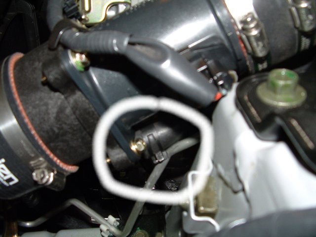

OK, here's the situation. My partents went away for a weeks.....oh sorry got distracted. A clip holding a tube onto my new Injen CAI was rotated in such a way that it was in contact with the 300psi A/C line and actually rubbed a pretty good chunk of the line away leaving a pin size hole in the line. That caused loss of pressure and loss of A/C. With there being no joints in the A/C line which runs somewhere near the drivers side front tire well to back into the firewall, it all has to be replaced in one peice. Parts $50 (not bad) Labor $300-$900 (ouch). Luckily I took the car to the guy who installed the Intake and showed him what happened. Jay at Stay Tuned Motorsports in Spokane, Wa said if i buy the parts he would install them and re charge the system at no charge. Very nice of him i though. I've attached a pic of the clip location before and after i rotated it. It's pretty easy to see the hole. I guess $50-$100 is better than $350-$1000. Oh yeah the part is on back order should be here in 3 days to 3 months. Goos thing summer isn't coming.

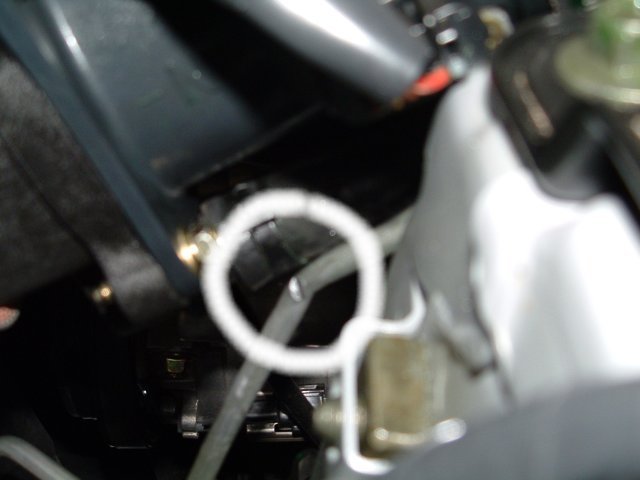

I rotate the clip to vertical and look what is left behind....a hole
