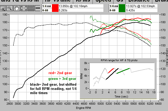

However, as I was testing with my brand new G-tech Pro RR (in, uh, closed tracks with professional drivers and all that, certainly not about 6 miles north along 277 at this bridge that is exactly a ¼ mile long). So, I put the numbers on the computer, had it do its horsepower and everything analysis and I saw this.
(Note, the black line is a pull I did through 2nd gear just to get the whole curve. The Red and Green lines are ones that the G-tech selected to calculate HP. The RPMs are measured through the cigarette lighter, so they’re consistently off- say, 300 rpm. However, I’ve compared this output to many online dynos and the shape is the exact same.)

Ok, notice that we have in this motor, a nice long, flat torque curve that goes from 3700-5000 rpm. Beautiful! Great for passing on the highway. Now, notice that both 2nd and 3rd gear begin AFTER the curve falls off when running the ¼. DOH! From what I understand about drag racing (that is, not much), you stay in the lower gear as long as possible, even though the torque curve falls off, you still get more effective torque through gearing.

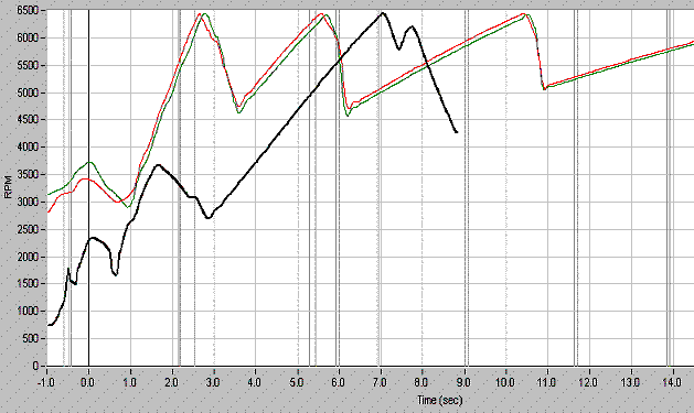

From this graph, see that 4th gear starts even higher than 2nd and 3rd (~5400 rpm)!

So, for this car running around a “13.9,” 2nd is 5300-6600, 3rd is 5000-6600, and 4th is 5400-wherever. The point I’m trying to make is that everyone racing his or her car and wondering why they don’t bring home the greatest times is cause Nissan handicapped the Z to keep us from breaking it. The only time you spend in gears other than first is when you get less than optimal acceleration. In any gear, the best acceleration in that gear somehow relates to making torque in that gear.

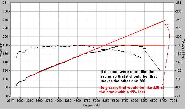

Ok, back on topic. I’ve modified the curves to show what it would look like if you could keep the torque curve flat, or even just from dropping off so ridiculously and I raised the redline to 7100 too. This is how Ferraris and Porsches make power. And I also bet this is how the M3 does so much better than the Z in the quarter. It actually makes the power in the RPM band it’s using. Then again, if I dropped $20K into a motor and it only made 333 hp, I’d be pretty upset. So upset that I wouldn’t be able to enjoy my nice BMW and have to come bother the pretty Z cars about it all the time
