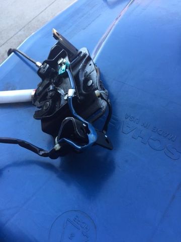

Originally Posted by bvitou
No I don't. Is this behind the plastic attached to the lid? If so does the whole plastic piece need to come off or is it right below where the lid locks down behind the seat? I replaced the 5th bow motor brushes and it worked fine for a few days but now it doesn't work at all with the lid stuck open.
I am gonna say it has something to do with being squished flat right where I circled:
