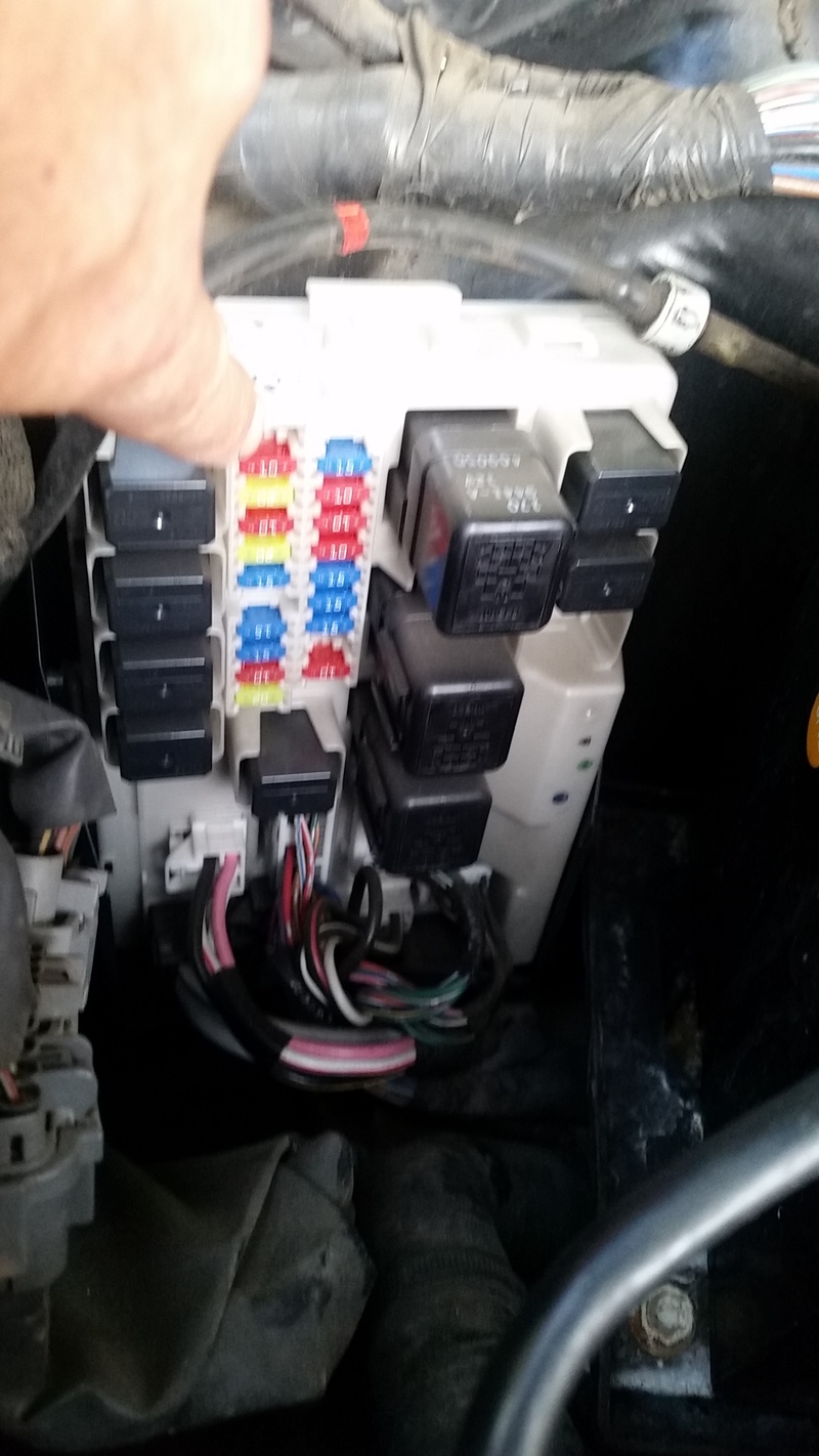

I had a fuse blow on me once when I was messing around with the parking light wires. It turned out to be in the "hidden" super secret fuse box under the hood. Had to remove some plastic pieces to get to it.

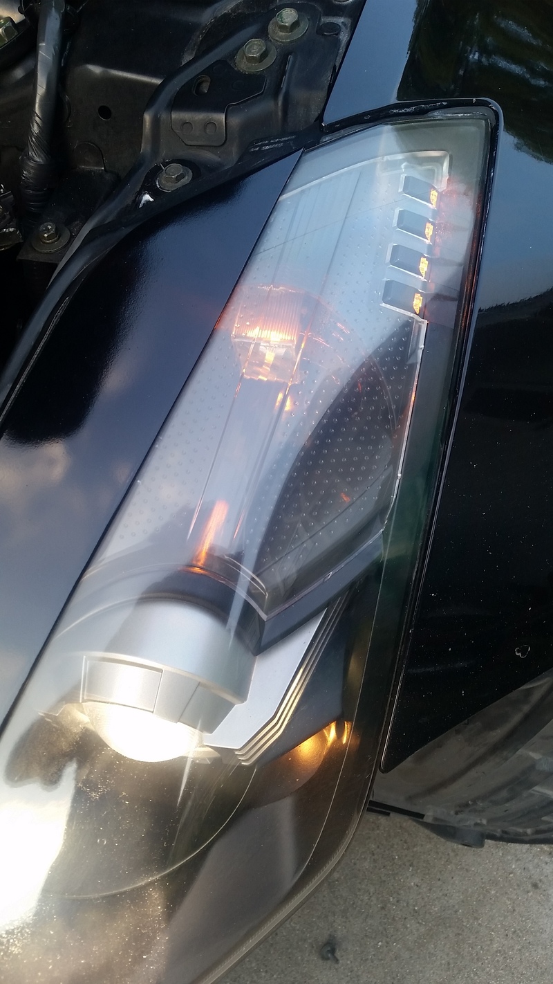

I solved the drl, parking light, tail light issue. A fuse is blown. The problem is that there appears to be a short in the right headlight and I will likely need to remove the bumper and right headlight in order to fix the problem. The fuse is in the upper left hand corner of the fuse box behind the battery.

Today, I removed the front bumper once again and pulled out the passenger side headlight. I could smell the burned wiring. what I did was a little unorthodox but I put in a 15 amp fuse in place of the 10 amp fuse and turned the headlights on briefly so I could see where the short circuit was and when I pulled the headlight out and took it apart it was very evident where the short circuit was. it looked like there was some extra wiring in the headlight so I cut it out and taped the rest of the wiring up and plug the headlight in and turned the headlights on. I noticed all the lights were working and there was no burning smell. all the lights that were not working where the tail lights, parking lights, side LED lights, and the daytime running lights.

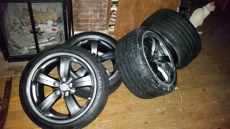

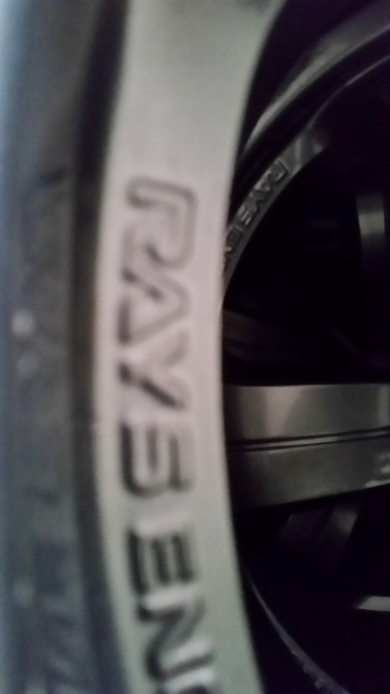

Clue #1:
Old May 16, 2015 | 01:43 PM
  #411
Whiskers1996's Avatar
Whiskers1996
Joined: Apr 2014
Posts: 545
Likes: 51
From: Florida Orlando

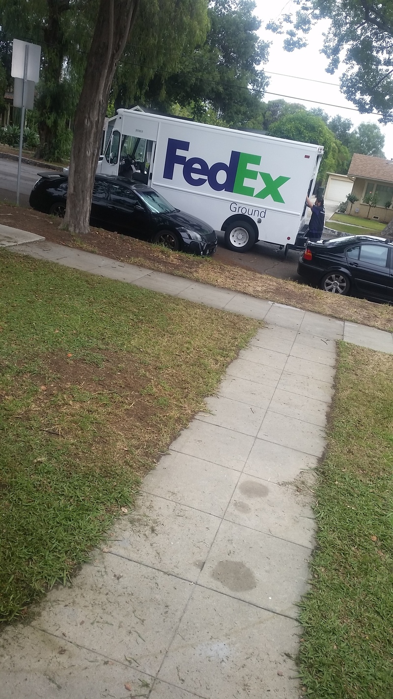

That first pic made me laugh so hard lol. I'm the same way though; when I have a part that is coming every time I hear a truck I run to the front door . Glad you got your wheels!
Old May 16, 2015 | 04:08 PM
  #412
Resmarted's Avatar
Resmarted
Joined: Jul 2009
Posts: 3,493
Likes: 64
From: ur face
I have about 5 grand worth of chit in the process of shipping to me. Eventually you get good at not paying too much attention to ship dates so you can get surprised every time a diesel pulls up and knocks on your door.

Yessir..I got Niz wheels! I too get jazzed up when I am waiting for a delivery. What makes it difficult is that I live near the post office so every five minutes a delivery truck drives by. Anyhow I got my wheels from Nizmo_0385. Thanks bro!! The wheels were clean and the tires look great. Took only 36 hrs from doorstep to doorstep. When I got the wheels I filled in some curb rash and minor gouges. Then I sanded the filler. I called my auto paint store and they said if I leave a wheel, they will color match the wheel paint. It will be $20 plus the paint. Ill need clear too. Then ill have Nismo decals made.
In the last pic, you can see some of the watered down filler on the tires. They are ready for primer after a good wipe down. Keep in mind, I plan to spot paint.
