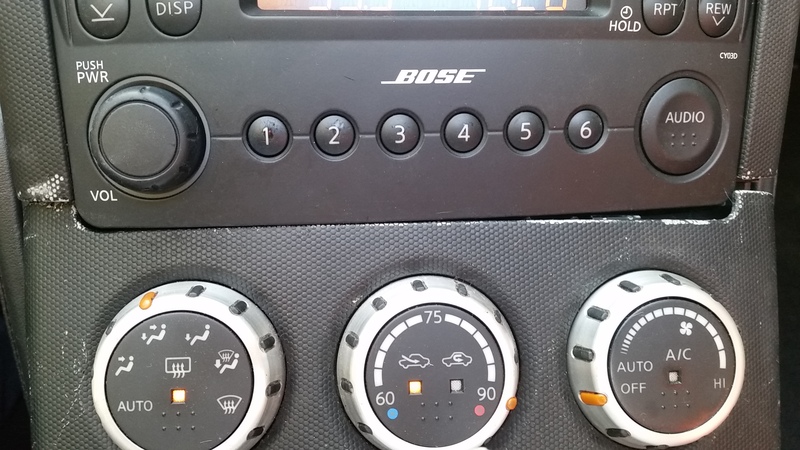

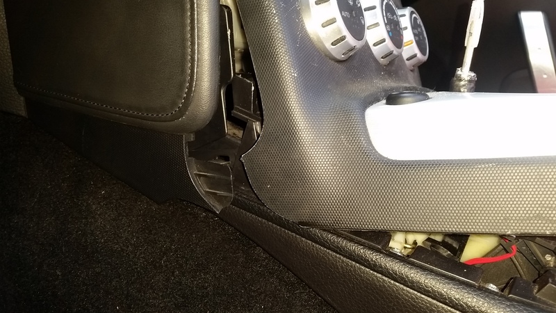

Some pics of the problem with the console:
First pic shows where the upper part of shift console meets the lower part of radio.

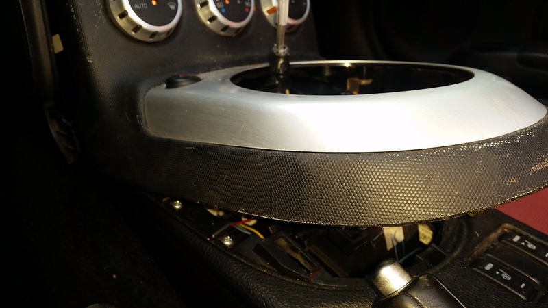

Second pic shows bottom shift console..it has over an inch to go to fit but it wont go
Third pic shows upper part of console...it still has far to go

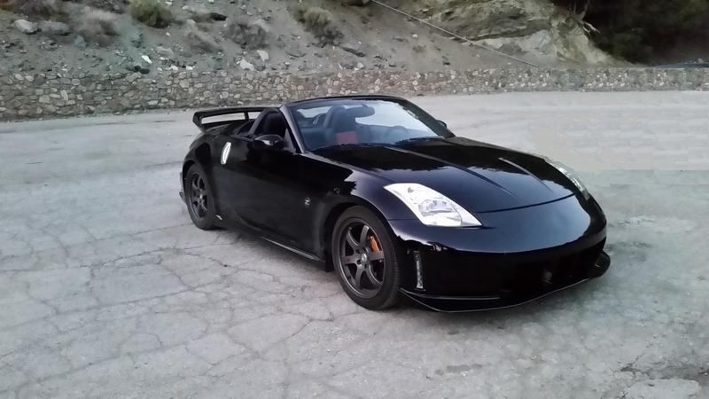

Sunday, I decided to enjoy the beautiful So Cal weather and drove up to Mt. Baldy to enjoy the tight 10 mph (yeah right!) twisties are the top. Here's a pic:

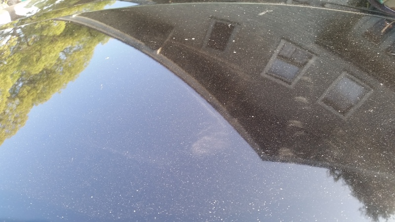

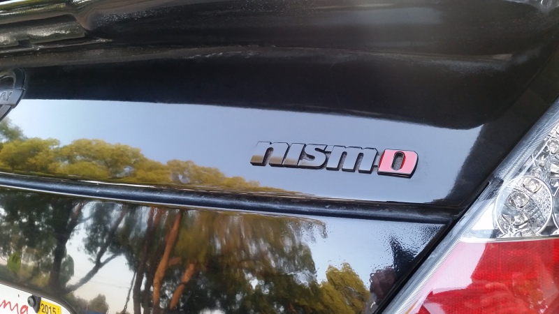

Today I worked on some fluff....I bought #9 meguiars swirl remover and did half the car. Also finished those areas with Zymoil. My random orbital buffer threw the cloth pad so i need to buy some new pads.
Before:

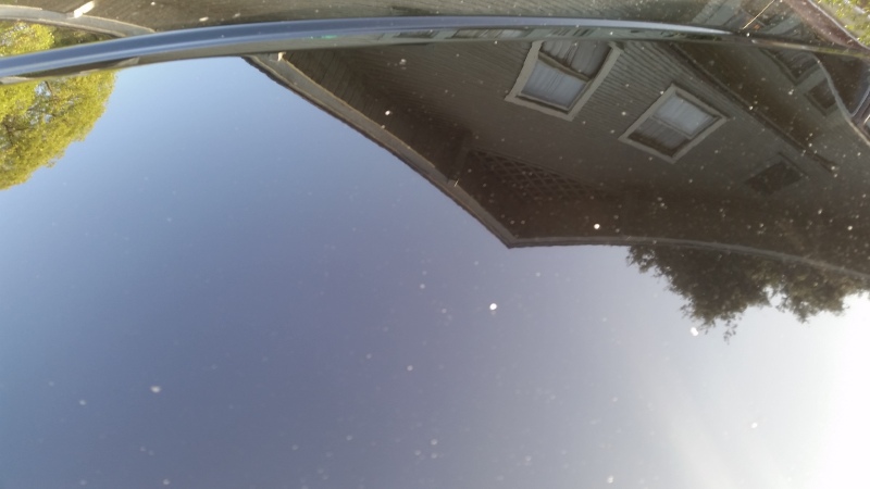

After:

Your issue with the console is that you need all of the parts from an 06+ - the waterfall, the climate control bezel, the two side panels with the leather knee bolsters, the shifter bezel and the storage compartment assembly that goes all the way back to the rear trim panel on the rear cabin firewall.
You cannot mix and match - just scour the classifieds, last year there were a bunch of threads for complete setups. Check out junkyards and ebay too, you will find what you need.

I have all the parts you mentioned from an 06+ - waterfall, radio and brackets, shift bezel, knee pads, and center console.

I dont think you have the right console, or it is not installed correctly. Look at your pic:
The front part of the console should go under the side panel like I have tried to show with the arrow.
Here is a pic of mine as a reference:
Sorry for the blurries but I grabbed it from a different thread and blew it up so you could see how the shifter bezel has a smooth transition, instead of the "hump" which is stopping you from sliding the bezel into place.
Hope this helps!

Yes it does help. Dark Z pointed out the same thing but the picture makes it clearer. I definitely have the correct parts. My long center console is from an 08 Z. Like you said, its too high and needs to be mounted correctly. Ill try to find time to unbolt it. What I could do it remove the long center console and try to mount the shift bezel. If that works, then we know that the long console was not mounted correctly, which we kind of know now. I appreciate all the help. Ill keep you all posted.

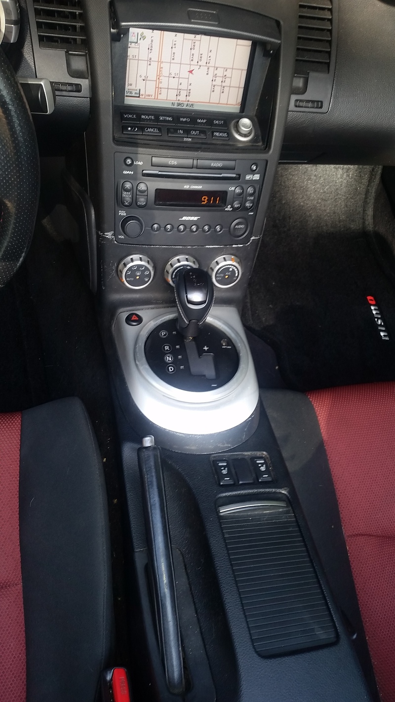

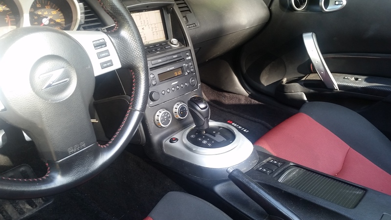

The tricky convertible top issue was partly solved. The next sticky issue was the console. But, thanks to DarkZ for help and a late night revelation. I was pretty much at my wits end about how to get the 06+ console to fit, specifically the shift bezel. DarkZ did some research and discovered that the manual shift bezel had the silver part screwed on to the bezel from underneath. However, the automatic transmission shift bezel has the silver part clipped into place, and for a specific reason. the automatic shift mechanism is a bit of a complicated device and, therefore, the procedure had to be different and the way it was different was the silver part simply pulls away from the bezel and then the dark plastic surround is unscrewed from the rest of the console.
When he told me this, I immediately went over to the console and sure enough the Silver part was clipped in place. I couldn't get out to the car fast enough because I was certain this was going to work. I basically took everything apart and I made sure the long center console was correctly positioned and I placed the dark plastic piece sans the Silver section over the shift mechanism. The silver section fit over the mechanism as well and then the silver ring went on top to finish it off. Here is the result.....
Thanks again to DarkZ for help. Its nice to have the car back together. I will need to paint z waterfall and the matching shift bezel area due to some scratching.

Thank you.. Next task is to take apart the newly put together consoles and paint them. I got black plastic paint and matte clear coat to protect the paint.
Another pic of interior:
