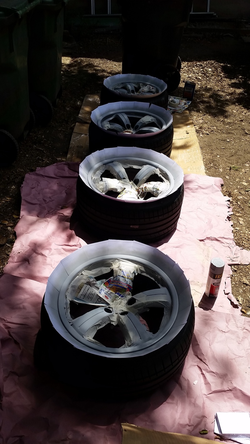

Update*** I did not have to go out of town this weekend so I decided to work on the wheels. The weather got a bit warmer than predicted, so the temperature is right in the range in which I like to paint. The humidity is a bit higher than I like but still not bad.
When painting wheels, I learned of this cool trick to prevent overspray on the tires. You take either playing cards or index cards and place them around the edge of the rim and that completely protect the tires, particularly if they are low profile. I had already sended the bad parts of the room where there was curb rash and a bit of gouging from rocks. The Nismo decals are off so no need to worry about those. When I paint the wheels, I will have some Nismo decals made up.
After placing the index cards around the edge of the rim I sprayed some filler primer to fill in the small nicks left after sanding the curb rash.
Next I will wet sand the filler primer until it is smooth and blends in with the original paint.

curious why you masked off spokes and parts of spokes?

The wheels are in good shape but I fixed the curb rash and some gouges in the spokes. The parts of the wheel that did not need paint got masked off. Ill blend the paint by wetsanding and polishing after the paint dries.

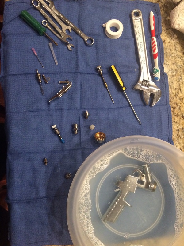

While Im waiting for the weather and my schedule to cooperate, I bought a touch up HVLPgun paint gun from Harbor Freight. It cost $35 and vame with a regulator. The first thing I did was take the gun completely apart and remove the awful silicone that is used as a dealer for the threaded pieces. I soaked the opened up gun in soapy water to remove the oil inside. I sealed the threaded bits with plumbers tape. Some of the silicone that was used to seal the threaded bit had plugged some of the holes. The cleaning removed all of that and now the gun should work as it was designed. The tip is .8mm. I figure this would be more appropriate to use for painting Wheels then a full size gun because of the much smaller surface areas of the Wheels. I determined this after much research online. still waiting for weather and schedule cooperation and I will give it a try. cheers for now....
Pic of gun taken apart:

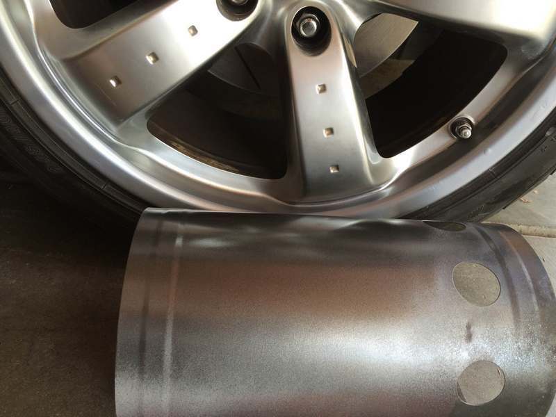

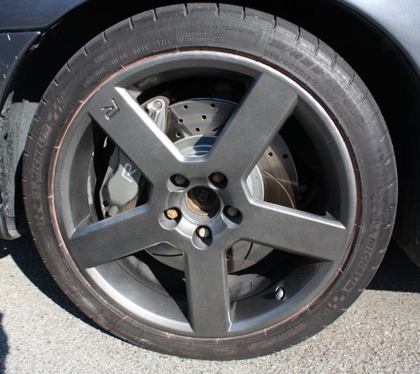

Reason for asking... still considering re-doing all the "new-to-me" Track V2 wheels on my '03 in a sort of charcoal/gunmetal/Nismo OEM color (just for a different look since I'm fixing the lips as you've done). Doesn't need to be exact because I'm just looking for a rattle can solution and if I can find KH2 in a can, well, works for me.
This was the final color of one of my recently repaired Volvo wheels and it's not really THAT close to the Nismo color but I kinda like it.
Used an old charcoal chimney to see what it would look like on my Track whills...
It's OK, wife hasn't missed it.
