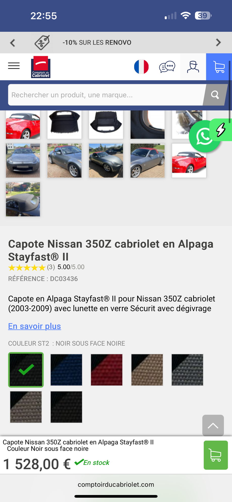

Ok thank you ! I’ve seen this one

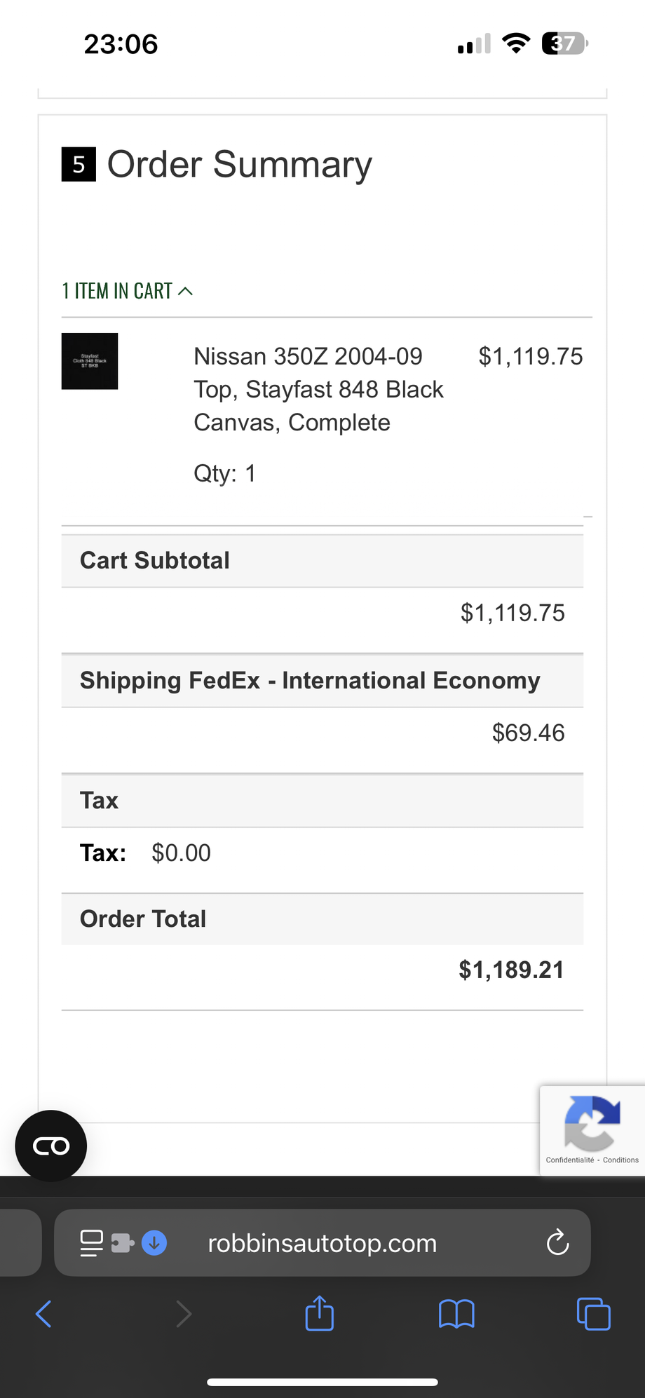

1500€ for alpaga, expensive now but another will be poor quality. For 600€ on amazon you have one or 200€ on AliExpress (same manufacturer I think, just drop shipping on amazon). I’ll put it myself in many days but will save money with your tutorials
EDIT : seen that one. Seems less expensive even if I deliver in France but no twillfast available only stayfast.
