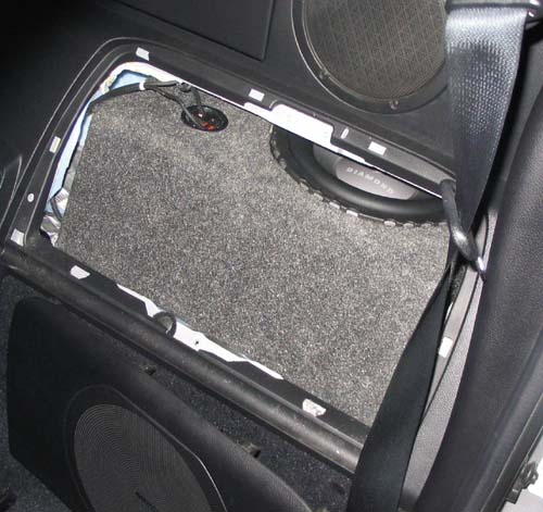

robcassell,
How about something like this?
It is fiberglass.
Tony
