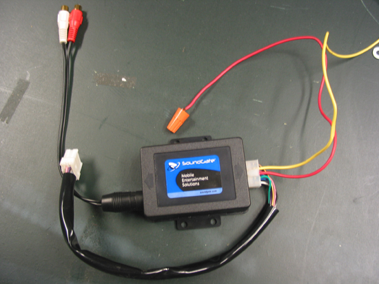

I do not have RCA inputs.. Just a CD Changer input. When you buy the soundgate audio adapter it turns the CD changer input into rca inputs.

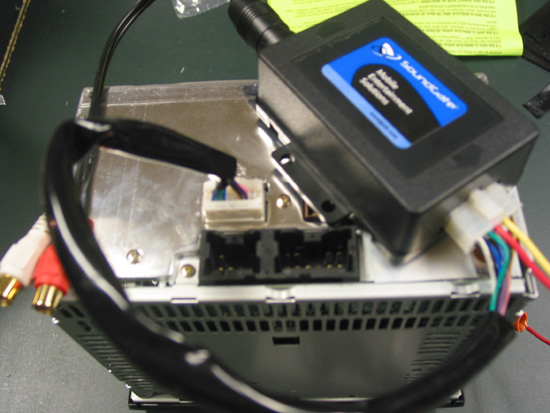

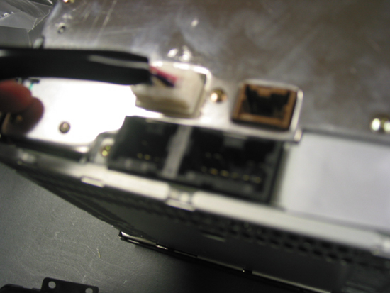

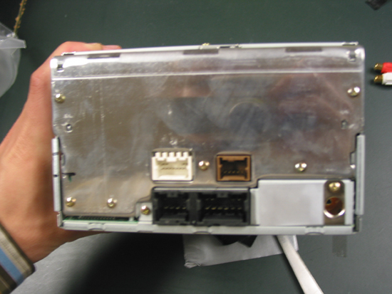

Proof..
Its nice being right.
The two bottom harness inputs are for things directly relating to the functioning of the head unit. Ex: speaker outputs, acc power, switched 12v power etc.... The harness input w/ the adapter plugged into it is the input that normally accepts a CD changer. This input if you do not have a CD changer stock, will still have a harness plugged into it. Its dead. It does absolutley nothing. It's mearly pre-wiring for if you would like to hook a stock CD changer up. The Soundgate adapter plugs right into it and converts the cd changer input into two RCA cables. Allowing you to plug a high quality audio line into it.
As you can see. This head unit has NO SAT button on it. And is NOT the Bose head unit.
BTW I am selling this adapter here:
