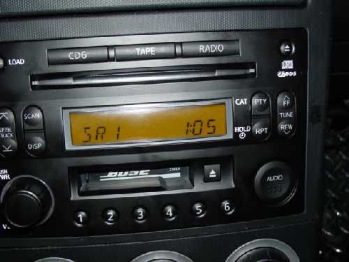

JCat's Avatar
JCat
Posts: 3,996
Likes: 76
From: JC in Atlanta Georgia
https://my350z.com/forum/attachment....chmentid=65875
Works for me.
Old May 15, 2005 | 06:39 AM
jkoc's Avatar
jkoc
Posts: 367
From: Canada
Crap. Mine is AMFM
