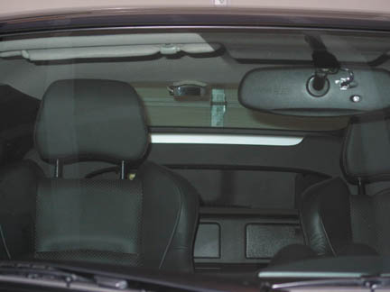

My goal for this installtion was to provide full functionality of the valentine 1 with clear views of the front and rear windshields while providing for a concealed display.
I did not like the idea of putting my $400 radar detector on the windshield to have it stolen by someone who smashes the glass and runs. Nor did I care for the idea of having to remove and replace the V1 every time I got out of the car.
So my idea was to figure out a way to install the V1 so that the main unit was hidden but provides clear coverage ahead and behind. To complete the installation requires the use of the optional remote display unit from Valentine.
The three pics below shows the locations I chose to install the various pieces for the install....

Default Main V1 unit placement
The main v1 unit is placed near the edge of the rear hatch. This actually provides a very clear view of the front windshield and of course rear facing. I have tested the unit for 3 weeks in this position and compared it to mounting on the windshield and did not notice any loss of sensitivty to signals when driving down the same roads.

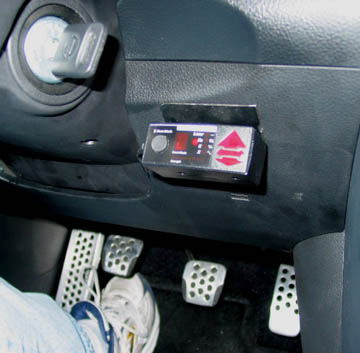

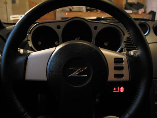

Default Remote Display Position
Now that the locations of the v1 main unit is in the rear we need the remote display up front. I did not want the remote display up high so that anyone behind the car could see the detector lights (especially the fuzz).
I chose to mount the display down low so only I and my passenger could see it period.
Notice the remote display in lower right hand of pic inside.

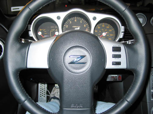

Default Remote Display Location
Here is a shot with the remote display light up....

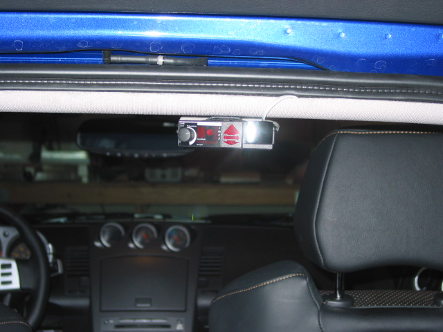

Default Mounting the V1
Now you are wondering how did he get the V1 mounted in that location near the rear hatch.
Well if you look at the headliner you will see one of those plastic grommets plugs that hold the headliner in place.
I decided to pop it out and use that for my mouting location. Now you need to be careful as both the headliner material and plastic plug are fragile.
Carefully pull back the headliner near the hatch opening and use a screwdriver to push the plug out from the backside.
Next I used the visor clip that came with the V1 and glued the plastic plug to the visor clip (minus the metal clip part). Now I can just push the entire visor clip with plug glued to it into the ceiling! From the pic you can also see I added some foam tape to help level out the V1 when in position and to keep it from rotating around too much during spirited driving.
Here is a pic of the visor clip with the plastic plug JB welded to it.
Be sure to scuff up the plastic plug before gluing to make sure the JB weld gets a good strong hold on it.

NICE! I'll have to try that when I get mine. Not too sure about having he remote display so low, though; from the pics, that looks like an awful long way to look down away from driving line of sight to check the display.

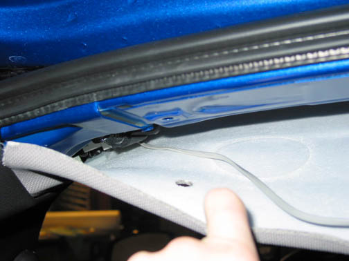

Default V1 Wiring
Now you need to run the power/ signal wire from the V1 back to the remote display.
You will need to pop out the rest of the head liner plastic plugs along the rear edge of the hatch area. Once this is done there is a really nice little passthru from the rear ceiling to the B pillar area behind the driver's left ear area. Once you get the wire to this point then just feed it along the roof rail and then down under the dash - not too hard.

Default Remote Display Mounting & Wiring
Below is a pic of where I mounted the remote display. It might be a little low for some people, but it works well for me. You can mount it anywhere you want. I went for the fully concealed display. I have found it works really well as you can see it quite easily when driving down the road.
I used a simple metal angle bracket and custom bent it to fit the angle needed. I used the little angle slider mount that comes with the remote display and riveted it to the angle bracket.
I then used some really strong double sided tape to adhere the entire thing to the lower dash panel as I did not want to drill any holes.

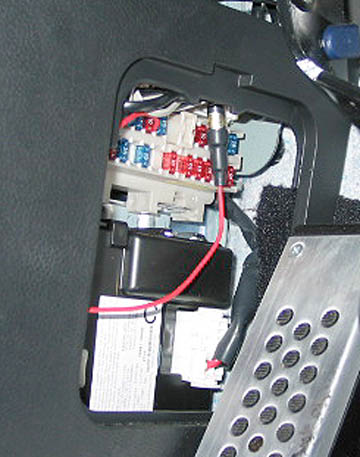

Default Fuse box hookup
Finally run the power wires from the remote display to the fuse box. Be sure to use a fused line (shown in red) to reduce the chance of blowing stuff up.

One thing I really like about this placement is that the V1 actually sits right below the third brake light!
Not only does this shield it from the sun and prying eyes, but you can't even see the damn thing unless you have your face right on the lower hatch glass.

This is great. I was thinking about trying to do a stealth install in the sunglasses holder. Then I checked the service manual and found that to get to the glasses holder/dome light assembly you have to remove the whole headliner, which in turn requires removing practically every other piece of plastic in the interior. Some 10 or so other parts, each with a dozen clips or screws. I decided it wasn't worth the trouble just to explore the possibility.
So your mounting method looks pretty good. I have two questions:
1. How solidly is the detector held in place? I'm worried that if you had to do a panic stop the thing could go flying into the windshield or, worse, into the back of your head.
B. How easy is it to remove? It has to come out when I go to the track.
Thanks for submitting the pics and answering these questions.
Old Dec 12, 2002 | 05:37 AM
jelledge's Avatar
jelledge
Posts: 293
From: Idaho
Default Answers
The V1 stays put and appears to be quite solid. The JB weld does a really good job of holding it in place.
I was thinking the other day that one could use something other then the plastic plug to hold it in place.
As far as removing it - no problem. I just pull back the headliner a bit and use a screwdriver to pop out the plastic plug and out it comes. Again I think something more durable and reliable then this plug would be very nice.
I don't go racing so the unit just stays in the car, but if you were removing it often I think the plastic plug would wear out over time. I was thinking the other day that you could use something with some sort of quick release latch -- still thinking on that one.
I had also thought about mounting the V1 in the sunglasses holder as mentioned earlier - but problem is the little black dots above the mirror will drastically affect detector sensitivity and I did not want to sacrifice performance.
