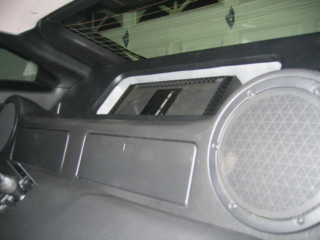

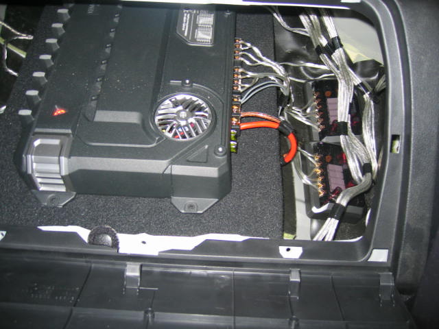

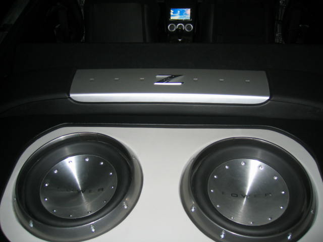

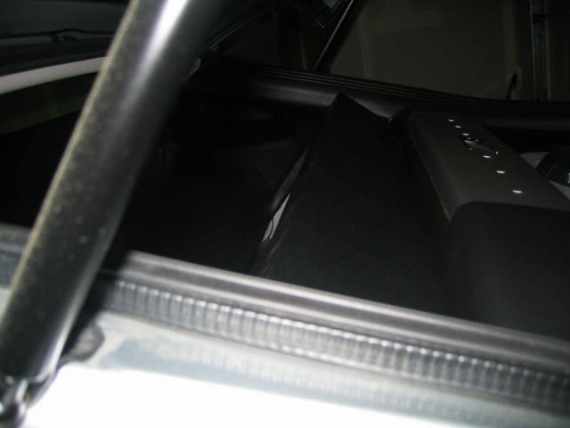

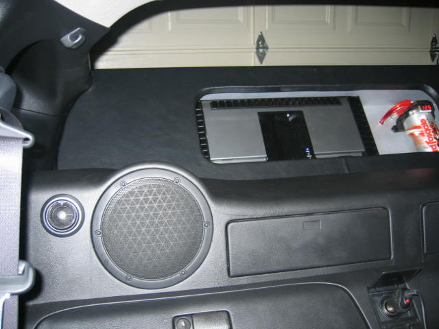

I got the custom box and 2 power 12's done in the trunk, the custom amp-rack and a power amp and stiff-cap, and a new in-dash excelon dvd player, as well as, excelon components replacing the rear speakers. Excelon components to replace the front will be installed on Tuesday. Hid the excelon four channel amp that is used to run the components in the compartment behind my seat. Neons will be installed on Saturday. If you haven't guessed yet... I like to use the word excelon... a lot. Sorry 'bout that.

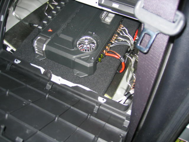

...and...cue the pics.

its 5.1, and i use that excelon 4 channel in the pics above. it runs both sets of components, front and rear. i use the crossovers that come with the components to filter the power to the highs and mids of each set. one set, which consists of 2 mids and 2 tweeters, will use two channels, then the other two channels power the other set, equalling 8 speakers amplified, from just one 4 channel amp.

Yeah me too, cause i got two so i can run them in parallel and wind up with only a 1 ohm load. then that way my amp pushes the full 1000 watts to both subs simultaneously. I get exactly timed hits that are both deep and perfectly in sync creating that bone shaking boom. I love it man. Rockford really stepped it up with that power line.
