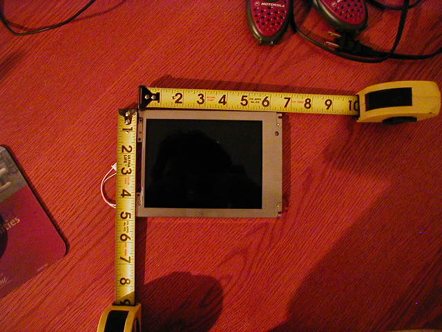

Here is the current screen that I am going to be working around.
That Xenarc is going to be way too big for the nav area, unless you strip it down. And if you are going to strip the monitor down, you might as well start out with a component.
hey Scaf. is that the new VGA you were telling me about? Size looks ok. Is it a touch screen? Have you teated it with the nav yet? I might be able to get a Group buy on the Xenarc , I think they will fit good with out the Case.
Old Jan 12, 2003 | 09:13 PM
Scafremon's Avatar
Scafremon
Posts: 1,660
From: California
Yes, this is the demo that was loaned to me. It can become a touchscreen by adding the membrane and the controller (about $100). This is a non-working unit (no video controller on it), but I have seen this screen hooked up to a computer, and it is beautiful. One thing to look at when choosing a VGA screen is the brightness level. You need atleast 300 nits for daylight viewing; 500 nits is better. I've seen some some VGA screens with only 150 nits, which are really only suitable for dark room applications.

Originally posted by abz123
What is it? Who makes it?
It's an LCD Raw Module. These are purchased by OEM's for inclusion in product (medical devices, elevators, control rooms, etc). I found a local company that imports them from Korea, and adds the additional backlighting.
The screen is currently being redesigned, so the LCD will be centered in the case. That should be available in March.
If you do a google seach on LCD raw modules, you will find various manufacturers. Most don't care about inquiries for one or a dozen units- they prefer orders based on yearly commitments of thousands. However, this local company I found seemed anxious to assist me, so I am hoping I can work out a good price on a few units. But it won't be until March.
