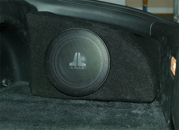

These were made with fiberglass with MDF for front mounting. They fit perfectly in the areas behind the wheel wells and take up very little space. The boxes are completely different shapes due to the gas filler tube on the right side of the car. This also created a little difficulty because of the air space requirements as well as the mounting depth needed for the sub. The rest of the hardware will be installed as soon as Circuit City gets the Metra kit in I ordered.
Here's the left box...

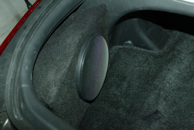

left upper

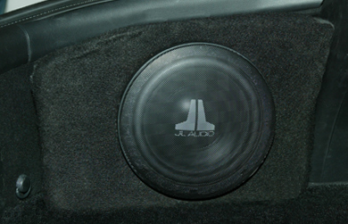

right box

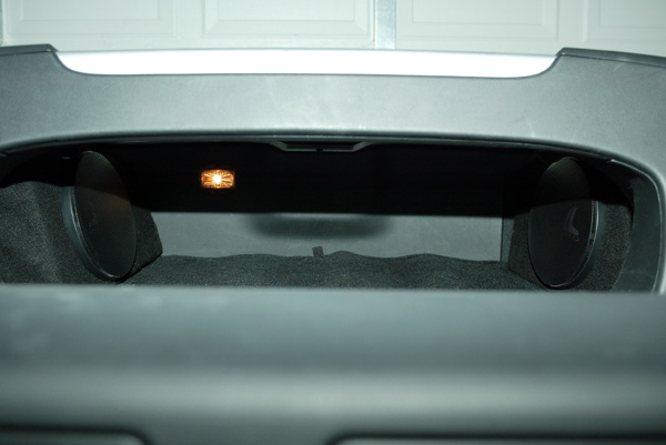

view from front...

looks very nice.
what size are those subs, and what is the volume?

They are JL Audio 8W3's. The volume is approximately .375 ft cubed. It's hard to be exact on this while working with so many curves and fiberglass being a pain to deal with in some areas.
I would have to say the hardest part was glueing the carpet on, though. The back and bottom of each box has some "patches" of carpet. Don't know how strong the glue is that I used but I hope to redo the carpet at some point. We'll see.

I really like the way that is done. Nice an neat job. Hope it sounds as good as it looks.
