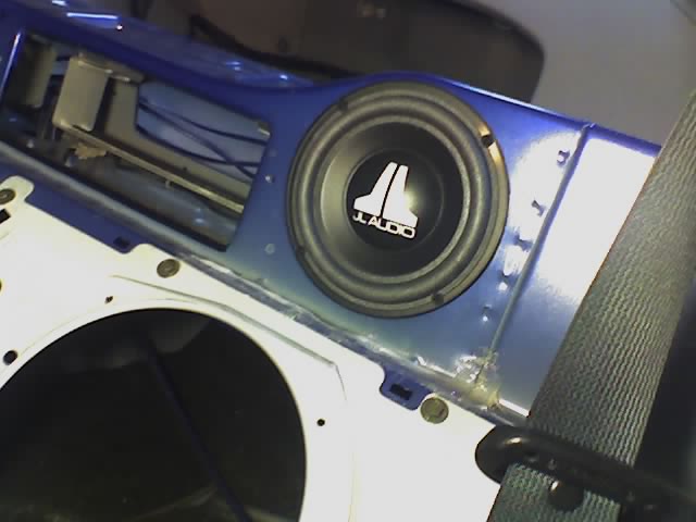

Started the installation last night.
We sealed off the back speaker holes and made them into enclosures using wood and liquid abs. Then I put 4 layers of dynamat extreme on the inside and stuff them full of polyfill.
We also got all wire ran, RCA's, speaker leads into the kick and the ott gague from the batter to the tire well.
Here is the end result of the 6wo4 I will be using for midbass in there new sealed enclosures
Old Mar 7, 2006 | 02:06 PM
jdohman's Avatar
jdohman
Posts: 268
From: Frisco Texas
picture of the 6w04 in rear enclosure. The facotry grills do go right back over so it looks stealth. Once I get some power on it I will let eveyone know how it sounds.

Nice work, but could you please explain to me why you would place your midbass (a speaker that produces fairly localizeable frequencies) behind your head.

because A. They are going to be used as my subs until I get my fiberglass done. B because they will be extending from like 50 to 150. which mean they will not take away from imaging in anyway. C. Because its cool as hell to have many woofers right behind your head.
anymore questions?

yeah. I will ask again how do you think that a localizeable frequency will not take away any from your front stage?

sorry you have to ask again. The part that I typed where I said they would be ambient once the 2 8W7's go in didnt save. They are being put in right now to act as much subs so I have nothing in the way when we are glassing. They will only be turned on after that if I have customers that A just want to hear something cool wiht alot of mid, or B are looking to get a smaller sub setup in there vehicle. Everyone says a 6" There is no way that produces any bass. I just want to show them otherwise.
