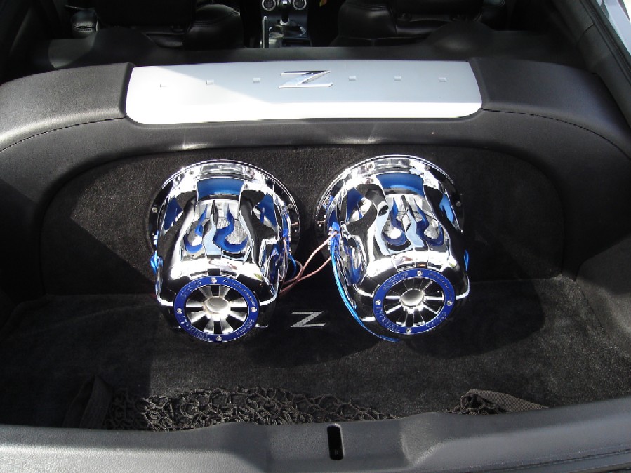

HEY GUYS HERES A PIC OF MY SUBS, YOU GUYS NEED TO DO THIS. IT SOUNDS BAD ***! THIS IS WAY TOO MUCH BUT I LOVE IT! BY DOING THIS IT USES THE HATCH AS A BOX AND IT PRODUCES REALLY DEEP LOUD BASS! THANKS TO MY BUDDIES AT ADVANCED CAR CREATIONS I FINALLY GOT WHAT IVE BEEN WANTING

wow that is beautiful!!

Nice set up... but I think the inverted subs still use the box for bass response. It actually gives the box more air volume when inverted. What are you pushing those with? Any more pics of your stereo? What HU are you using etc. Thx!!

IM PUSHING THESES WITH A THE HIFONICS 1605D MONO BLOCK AMP, IT PRODUCES 1600RMSX1 AT 1ohm. THE ETERNALS HANDLE 900RMS EACH SO IT CAN RUN ATLEAST 100 RMS MORE LATER, BUT IM NOT BECAUSE I JUST BLEW SOME AUDIOBAHN AW1006T WHICH ARE THE ALUMINUM ONES THAT SUPPOSEDLY HANDLE 900RMS. IT TOOK A GOOD 2WKS TO BLOW THEM OUT THIS AMP KICKS A$S! HEADUNIT I HAVE THE JVC AVX1 WITH THE BUILT IN 3in SCREEN. SORRY I HAVE NO PICS OF THE HEADUNIT.

It does rather seem overkill, I'd rather not add the weight. Glad you like it.

I'll bet you that you'll not be able to hear the difference between 900 watts and 1000 watts. To make a 3 dB difference in the sound - one tick mark on the volume control difference you'll need 1800 watts (an additional 900 watts) that last 100 watts ain't gonna do jack.
Although it's not the easiest thing to comprehend, doubling the amplifier power does not double the loudness. In the above example, the sound from the speakers would not be "twice as loud"; it would only be "a little louder," an increase of 3 decibels. How loud is that? Hearing tests with large groups of people have revealed that a one-decibel (1 dB) change in loudness is approximately the smallest audible step that the average listener can detect, so an increase of 3 dB most listeners term "slightly louder."
To really light those things up with another 10 dB you're going to need a 9,000 watt amplifier.
But save enough of your money for hearing aids.

YUP THATS TRUE,I WONT BE ABLE TO HEAR THE DIFFERENCE BETWEEN 900 AND 1000 WATTS.... I THINK I ALREADY NEED HEARING AIDS LOL!

Paul you and I both know that is in a perfect world. Being from the DB drag world and being a national competitior I know that just because you double power doesnt always give you a 3 db gain. Most the time it is between 1.5 and 2 db gain.
not to bad. Not my choice on subs but I am sure they hammer for ya.

mmmm .. distortion ... power compression... yummy
Setup looks nice and showy ... very cool.
