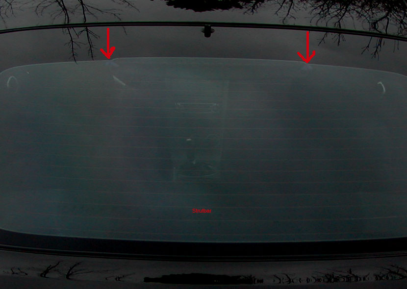

This pics sucks but here is what mine looks like. I had to darken the pic to get past the glare on the rear window but you can see the 2 purple pieces of foam I have placed between the plastic/window. I haven't bothered to make it more discrete yet but will soon.
Unrelated: You can also (kinda) see my strutbar which I covered with fabric. My tint is only 35% but covering that silver pieces darkens the whole back of the car.

ah, so you just tinted the entire windshield? you didn't decide to go around the brake light? does the light still shine through? the way you have it, it's practically impossible to tell you have foam pieces on there, good work
i guess if i was going to tint the entire thing, i'd just compeltely take that plastic light diffuser thing out altogether and disconnect the rear brake light

They tinted the whole rear window and the center light is still plenty bright. 35% is legal and my pic doesn't show it realisticly. Black car, black interior, black strutbar....it looks darker than it is. The LED's of the center light are still quite visible.
