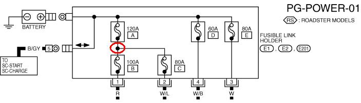

Originally Posted by Paul350Z
The Z has an extra 10mm bolt ready and waiting at the (+) 12V terminal for amplifier wires so you don't need an adapter but you do need the major fuse up there.
From what I can tell by looking at the schematic, that extra bolt on the fusible link assembly (that hangs off the battery + terminal) is fused with a 120-amp fusible link. That same bus powers the 100- and 80-amp fusible links on the right side. I'm not sure hooking up amps here is a good idea, because if your amps (combined with the other stuff on that bus) draw enough amperage, you will blow that 120-amp fusible link and lose half the car's electrical system.
Have you tried it without any problems?
The other 10mm terminal where the starter is attached is straight to the battery terminal with no fuses. It might be better to just attach your amp power there... ?
Here is the schematic. The red circle shows where the spare 10mm bolt is attached in the assembly:
