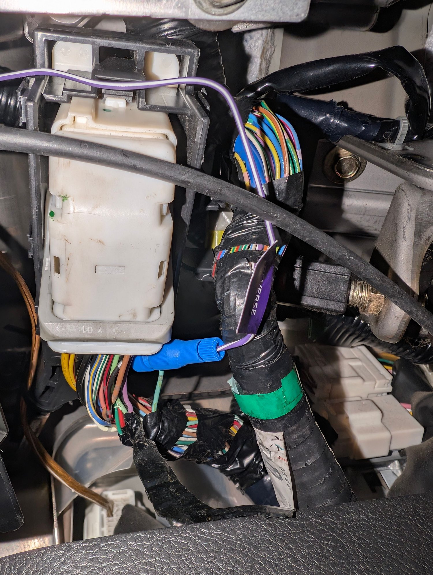

Lightbulb 2003-2006 Nissan 350z Reverse Wire near drivers side kickboard with picture
Long story short, there's not a good forum that shows this and wanted to put it for someone who may need it.
On the driver's side remove the left kickboard and look for the large connector with a lever, pull the lever all the way back and remove the connector. Then look for the wire shown in the image attached. It is a teal wire with silver spots. It is not orange. The orange wire is the mating wire on the connector this one plugs into. It is more difficult to get to.

Default Reverse wire trigger (03 350z manual)

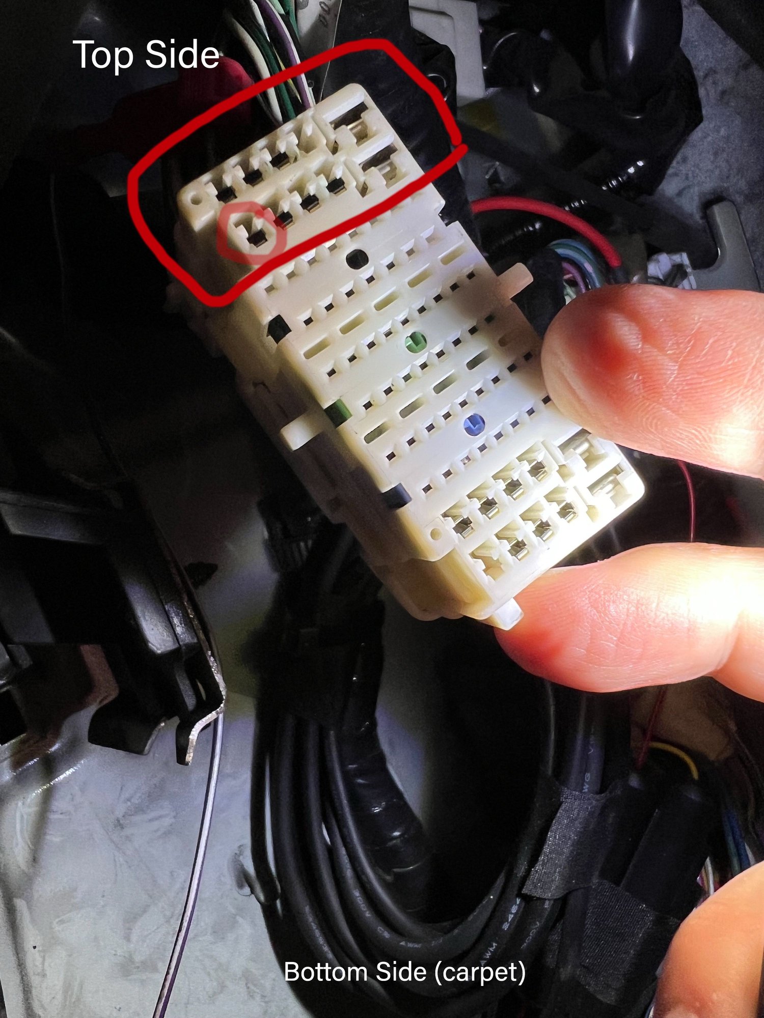

After searching wide and far, this photo really helped a ton along with the other sliver of information I could find elsewhere. All saying different things though, so just to help narrow some things down for others.
I can only confirm for my specs[2003 350z manual]. If you take a look where rlg50 is tapped into you may get confused when you find 2 teal wires with silver spot. Another post from someone in the thread posted just a pin diagram (but it was not able to load for me). Either way just adding to the pic above, but it should be the teal w/ silver dashed wire that matches the pin drawing in this thread (helped me solve my problem of tapping the wrong teal wire).
The purple reverse trigger wire (kenwood) to the teal with silver dashes that routes to the red highlighted area.

Teal w/ silver dashes for the reverse trigger is connected to this side/set on the connector.
Head unit: Kenwood DDX9907XR
