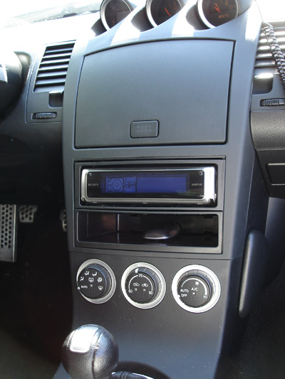

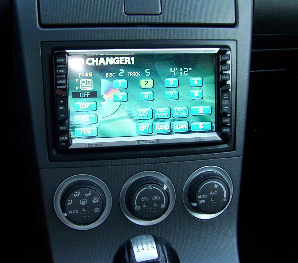

Okay, I have managed to steal pictures from some members' previous posts to show you.
Note one headunit is double the size of the other. This is a "double-DIN" headunit. "Double-DIN" just refers to the space the headunit takes up, that's it. Single-DIN is, well, just takes up half the space of a double-DIN headunit. The stock Z deck is obviously a double-DIN headunit. There are advantages/disadvantages to both. The main difference being that double-DIN headunits do *not* have "detachable" faces (true in general, I'm sure there are exceptions). I'm assuming you know what that is? You know.. have you ever seen people carrying around part of their stereo? They detach their "faceplate" so that theives won't steal the stereo. I mean, they still can, but just stealing half the deck is worthless without the faceplate, right?
Also notice that in the picture of the single-DIN picture, there's a little "pocket" or "tray" below the headunit where you can put stuff like a cell phone or whatever. This will come with the "kit" needed for the install. You'll have to buy the kits seperately, or the audio shop will always have one too. Don't worry, they're really cheap... like $10. Double-DIN headunits are generally more expensive as well. Single-DIN headunits are vastly more popular and you will have much more selection to choose from. There are plenty of reputable companies that make headunits (Pioneer, Kenwood, Alpine, Eclipse, etc.) so the possibilities are really endless as to what kind of headunit you want to buy. All depends on what you're looking for (features, price, quality, etc.) Let me know if this helps.
edit: Where are you in CA? If you want, I can meet up with you if you're close to me and show you my system and let you listen to it.

What brand is that double-DIN head unit in the picture above?
Old Jul 5, 2006 | 10:00 PM
sanphasouk's Avatar
sanphasouk
Posts: 16
From: Vancouver,WA
Eclipse
