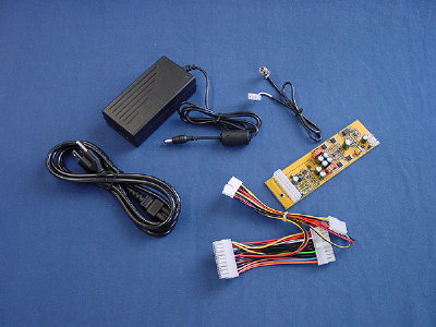

What about this thingy?
I believe this is what ships with a Casetronics case for a mini-itx motherboard. I think it just takes a 12v DC source, and splits it up into the various voltages the computer needs. Wouldn't using this keep things simple?
As for powering up/shutting down, I'm going to have a EE friend look at the schematics, and see if there aren't existing relays/contacts that can be utilized. For instance, if you shut down your engine with your headlights on, some circuit closes to initiate a 'beep' warning. Your lights still have power, but a signal initiates the beep. A similiar circuit could possibly send a singal to the motherboard to initiate hibernate mode.

I bought my case and motherboard at the same time...so they put it together for me.
Not sure if this is part of the case or not (but usually it is when you buy a case seperately)...
Few things I've noticed not in the picture other than the case:
1) cable to power the board on and off (along with buttons).
2) cable to reset button (along with buttons).
3) USB cable (front connection)
4) sound/mic/audio input cable (front connection)
5) firewire cable (front connection)
6) screws and spacers
7) other cables like for HD indicator.
8) Two 2" case fans.
9) Front panel plate.
Funny how they list the 2699R as having a 60 Watt power supply now. I was one of the first to get one and I remeber it being adverstise as 55 watts. Did they actually switch out the P.S. or are they playing around with numbers? At least a lot of the sites (like Idot) are finally acknowledging that there is a power shortage problem with the M series.
