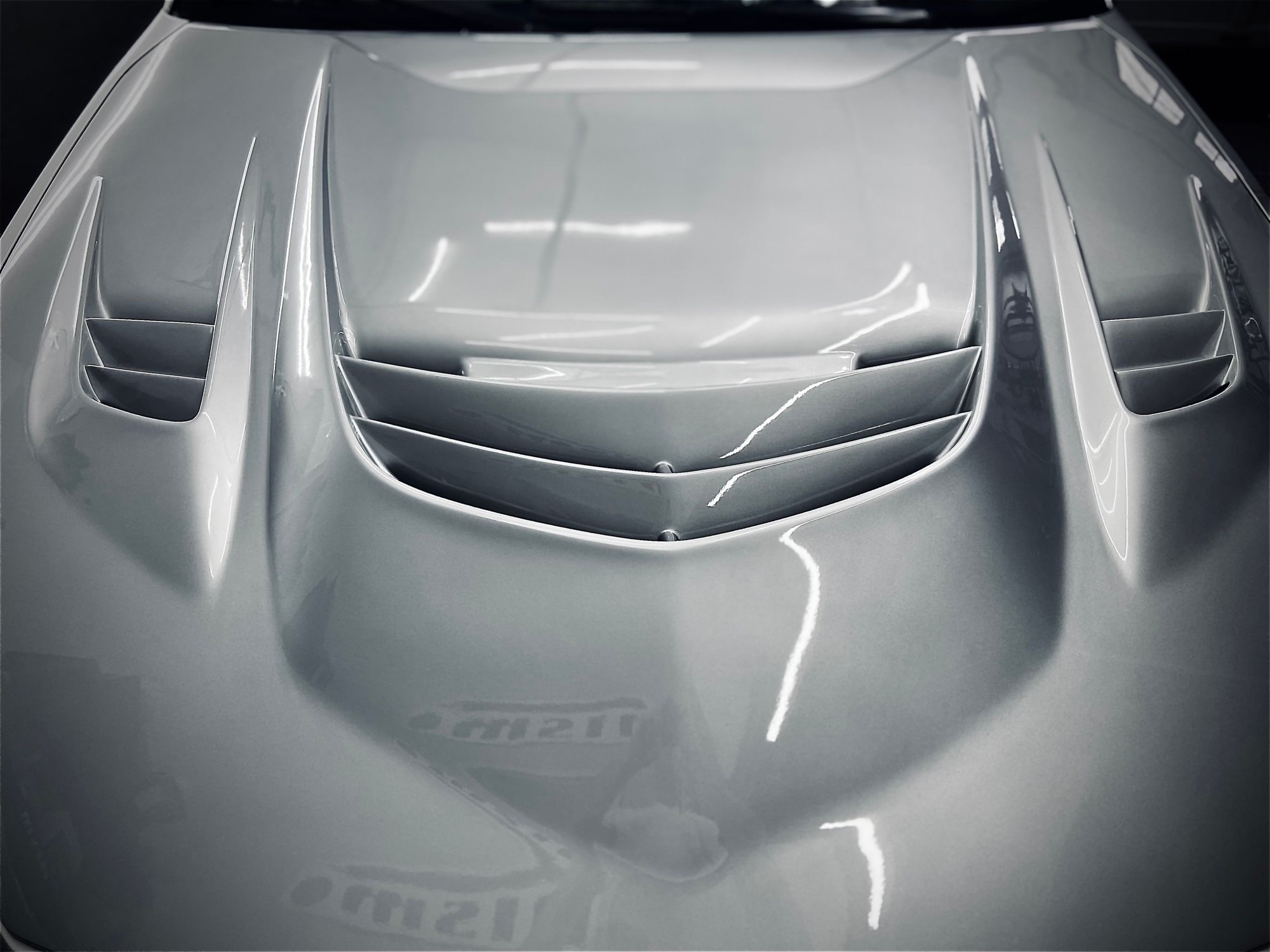

The MCR will bolt right up. It's highly unlikely it's an authentic piece with fitment issues. Where did you get it? Are you sure it isn't a knockoff such as Fly1? Post photos of the underside and the latch area if you have them. This is a pic of my MCR after delivery. Usually the latch area and overall construction is a dead giveaway.

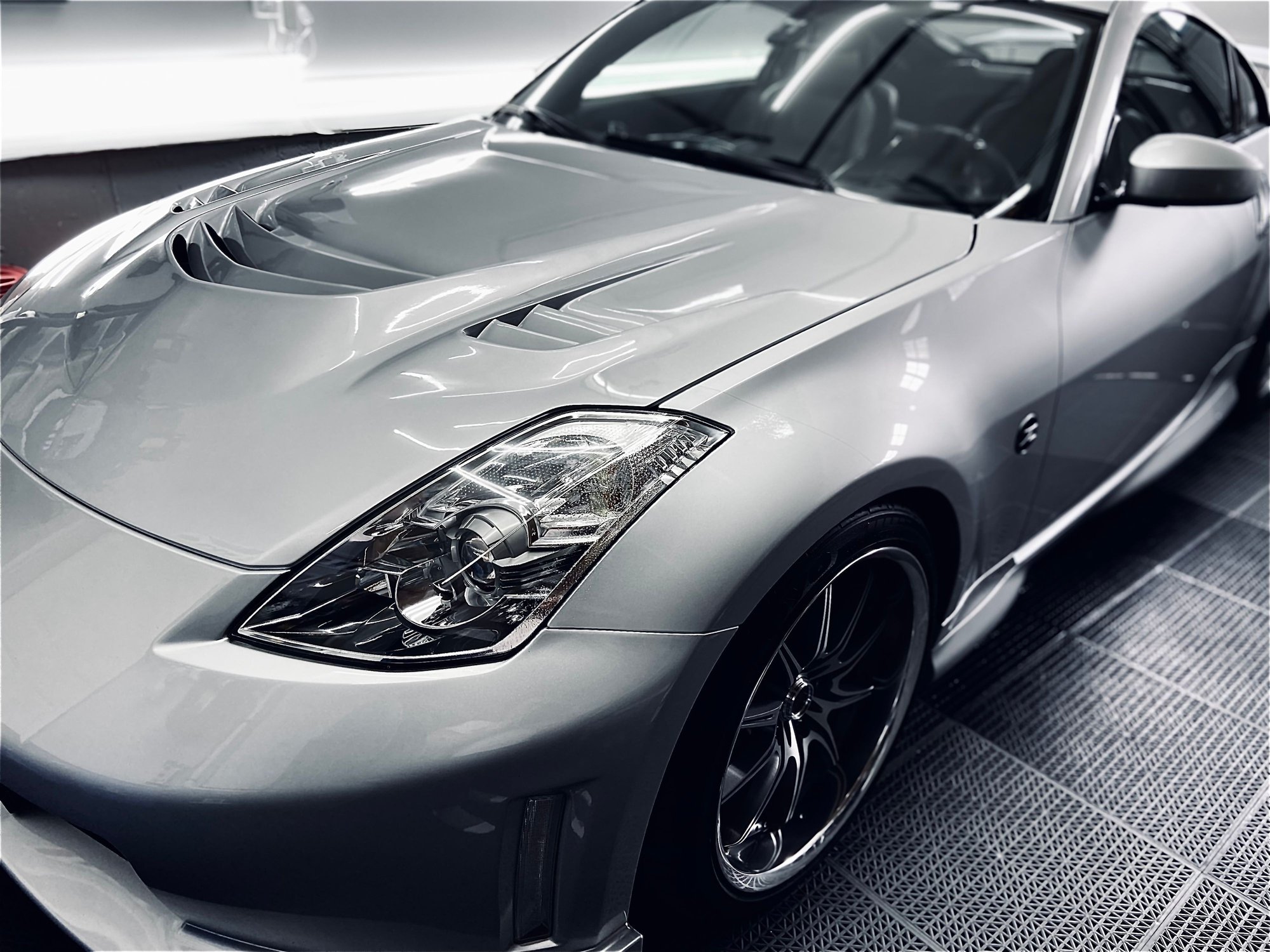

My MCR hood fitment is near perfect.
