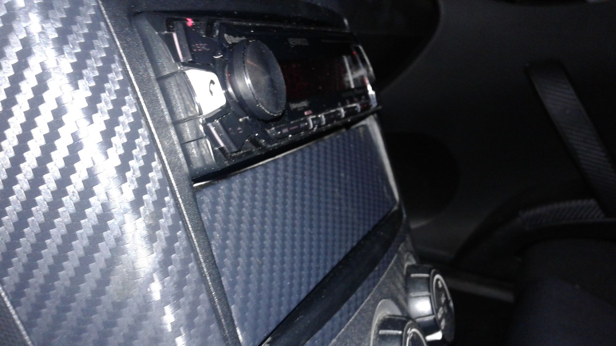

Here's the deck, with the Bass **** below.  Newly painted waterfall and repaired cubby door as well.

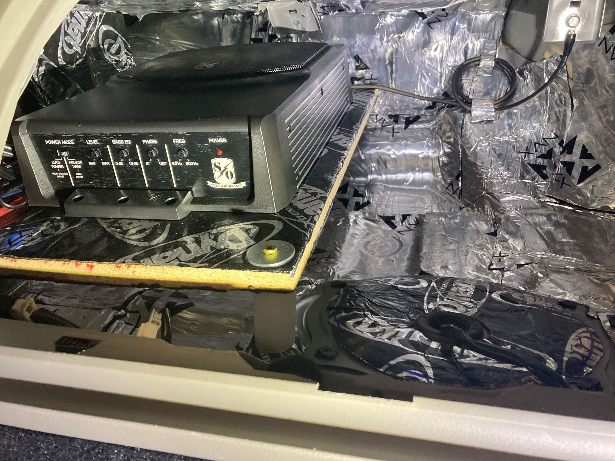

Amp mounted behind passenger seat on the wall below the glove box.  Plenty of room along the top of the panel for a couple screws, and again, plenty of room for a third on the bottom left.  It's very secure here, and glovebox retained.  I'll hide the ground under the carper when the seat goes back in.
Amp mounted behind passenger seat on the wall below the glove box. Plenty of clearance behind the top of the panel for a couple screws, and again, plenty of room for a third on the bottom left. It's very secure here, and glovebox retained. I'll hide the ground under the carpet when the seat goes back in.

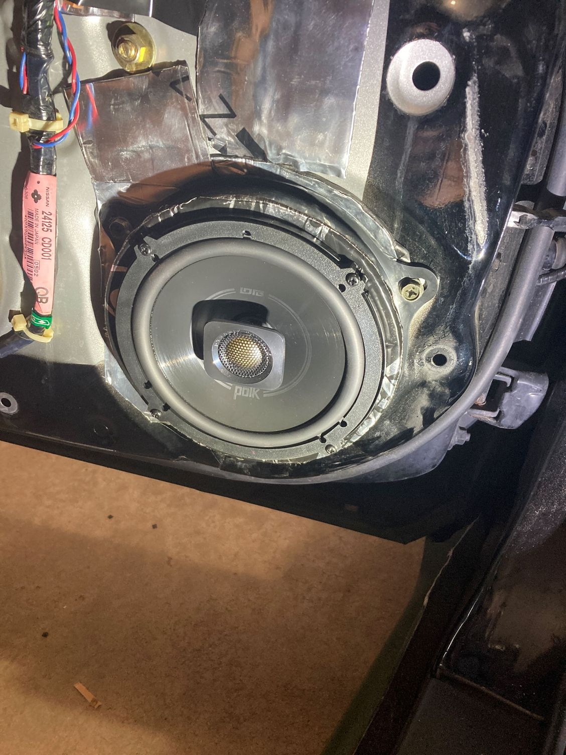

Here's the Polk Coax in the door.  For $99 a pair, these really sound great with the Rockford Amp sending them 125W RMS.  I have Polk Components in my truck and these coaxes sound just as good to me.

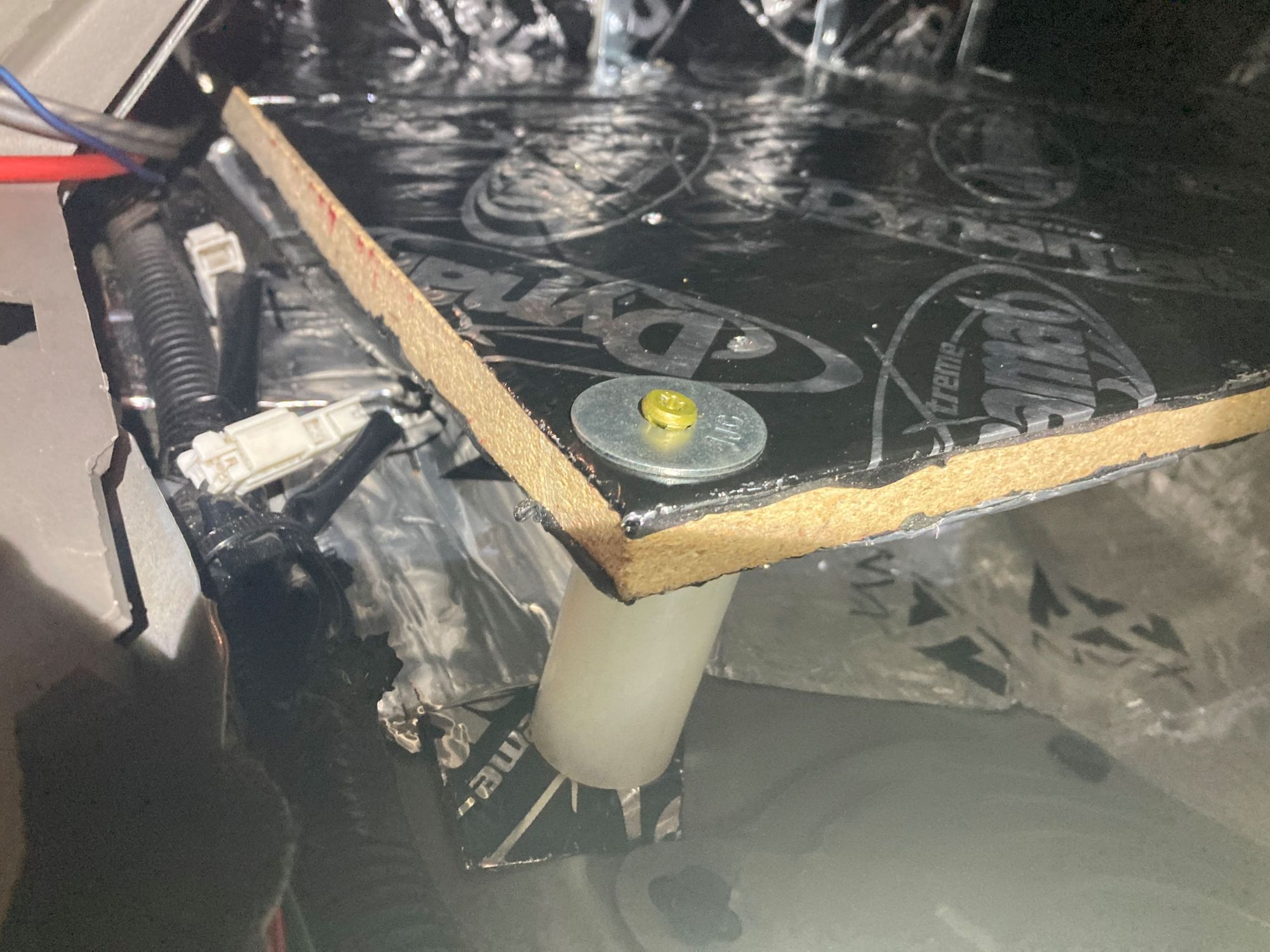

Then a leg cut 2 1/4
Then a leg cut 2 1/4" long from a piece of 1" Pex. 4" screw with large washer. Again, plenty of clearance underneath where the screw attaches. I might pull the screw and use a hanger bolt with a nut on top just for a little cleaner look. Will also Dynamat the board edges.
