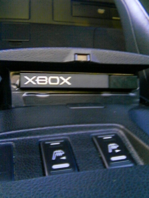

I am currently embarking on this myself.
First off you need a switch box to beable to switch between nav disc to aux imput. check out http://www.tvandnav2go.com/ to purchase their unit.
it cost 200 bucks for non-plug and play - ie 4 wires need to be cut and spliced in.
or 250 for plug and play version.
Also, then you need aux imput for secondary signal - example - im using an Xbox in the glove box behind the passenger seat. I ran 8 gage wiring and installed a power inverter in there to power it.
HEre is where i got my info. follow this site:
http://home.comcast.net/~jcage89/navbox/
You do however need to mod the x box inorder to play dvd's on xbox. i choose the x box because i plan on modding the Harddrive to a huge one to have movies and mp3's, and windows media files on it saved and easy access. the mod chip you need is: SmartXX v3.0 mod chip with the Xapt3r for about $74 - see www.mod-chip.com
NExt you need The XBMC software is not included. You have to find it for yourself. - just google for "xbmc download"
http://www.mod-chip.com/Lite/How_To_...ox_Version.pdf
Very easy. And we have easy to follow step by step manuals.
The chip loads a new Bios (=Operating System) to the system. Its like a new windows for your computer.
any other questions let me know.

nope. not at all easy, but im sure worth it. i like the idea of utilizing the nav screen for more......
Im doing it in phases. I bought the xbox months ago for a 100 bucks with about 5 games at a pawn shop. then from JCAGE web site i went out and bought the door bell for like 15 bucks at home depot and installed that. so now my x box turns on remote controlled wise.
then i went out and bought a power inverter. i got it on sale for like 26 bucks. 400 watt. then one day during my lunch break i went down the street to the car audio place and bought about 20 bucks of 8 gage wire and $13 fuse box and ran the wiring.
So now i need the tvandnav2go box - which im finally purchasing this week.
next im gonna go to radio shack and buy the rca to 3.5 mm adapter so i can use my tape deck head unit for the sound. and thats temporary until i get the www.pac-audio.com AAI-NIS2 which cost like $100 on ebay to handle the sound.
so darnn!!!
- Jason!

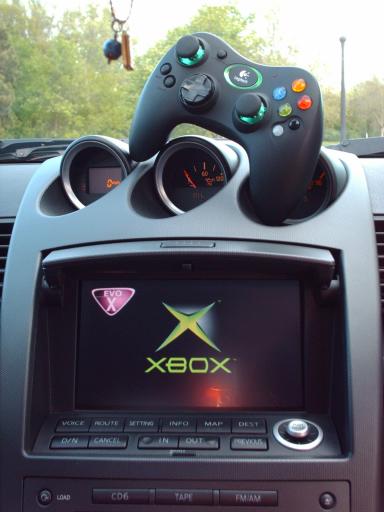

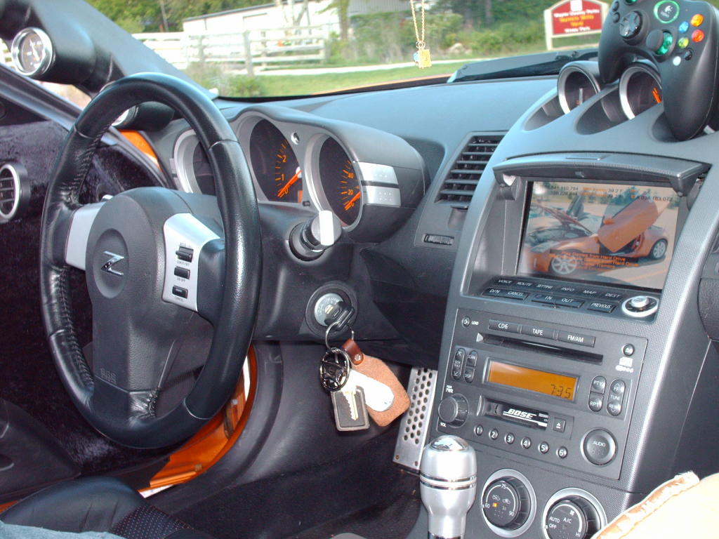

navbox isnt around anymore? that sucks. it saved me a lot of time and a little bit of money. what about the nonag that "pushes" the i agree button for you on the nav screen? best $60 i ever spent. good luck with the install. be sure to post some pics.
