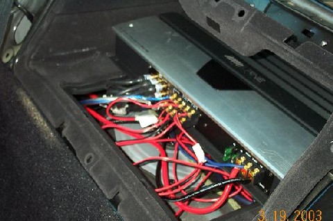

here's those picts of the amp in the glovebox:

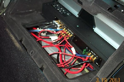

cover down:

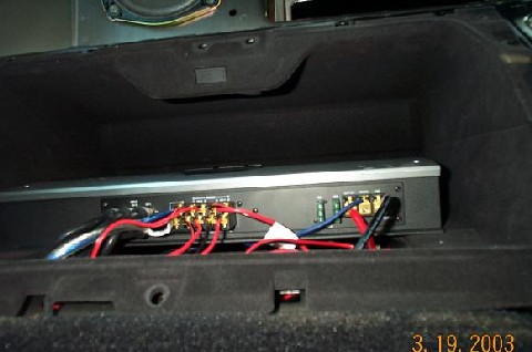

front view:

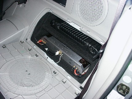

Here's mine. I used 1 Phoenix Gold 1.2F cap...it will help alot. A few have upgraded to an Optima battery, but I think the stock system is OK. I am not sure what the ampere rating on the stock alternator is, but when my system is loud, the lights (interior and exterior) do dim slightly. I am running 4 gauge from the battery to the factory Bose location where my amps reside. I may consider a battery upgrade in the near future, if I can add one without too much trouble.
