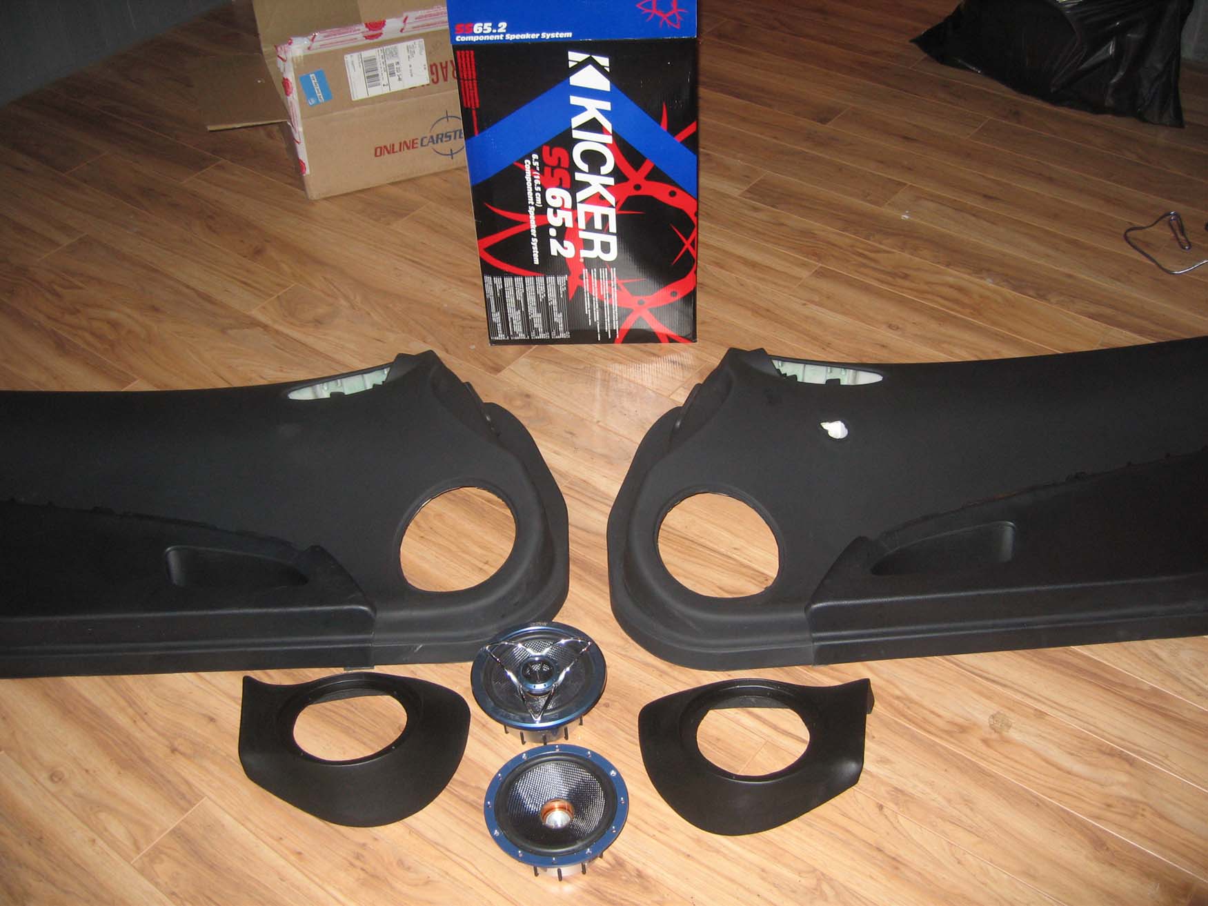

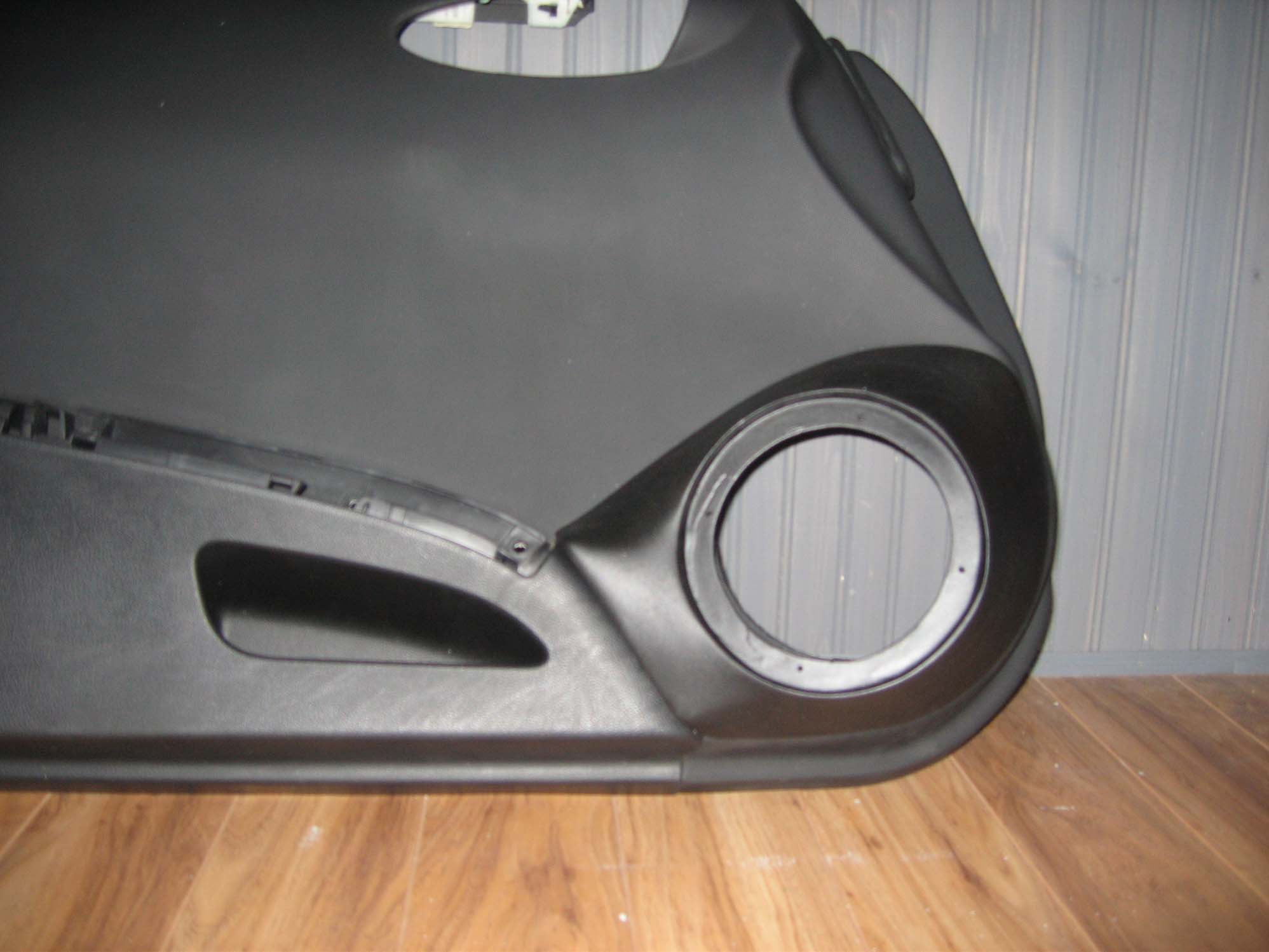

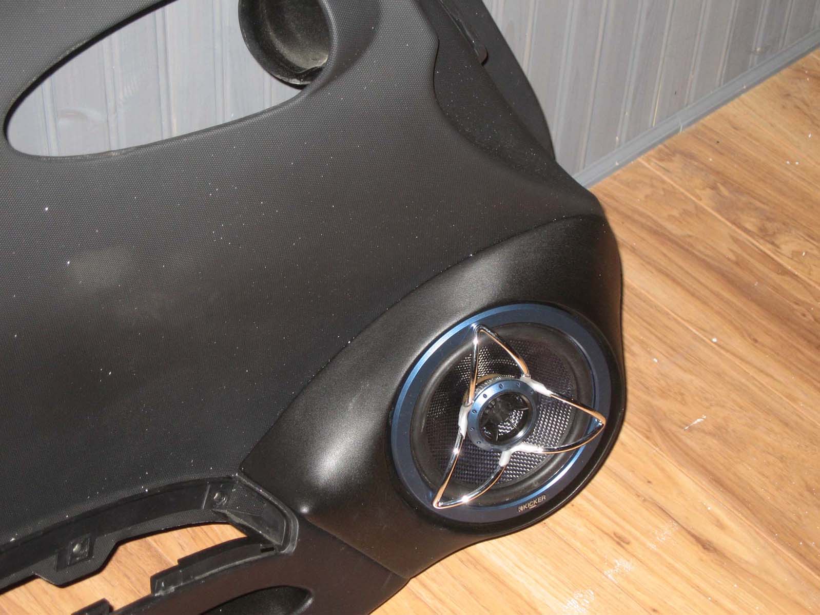

I will say after a fair amount of prep work they turned out pretty good. Pics dont do the paint any justice its a damn good match to the plastic on the window and lock controls. Just did not like the vinyl this is a much closer match.

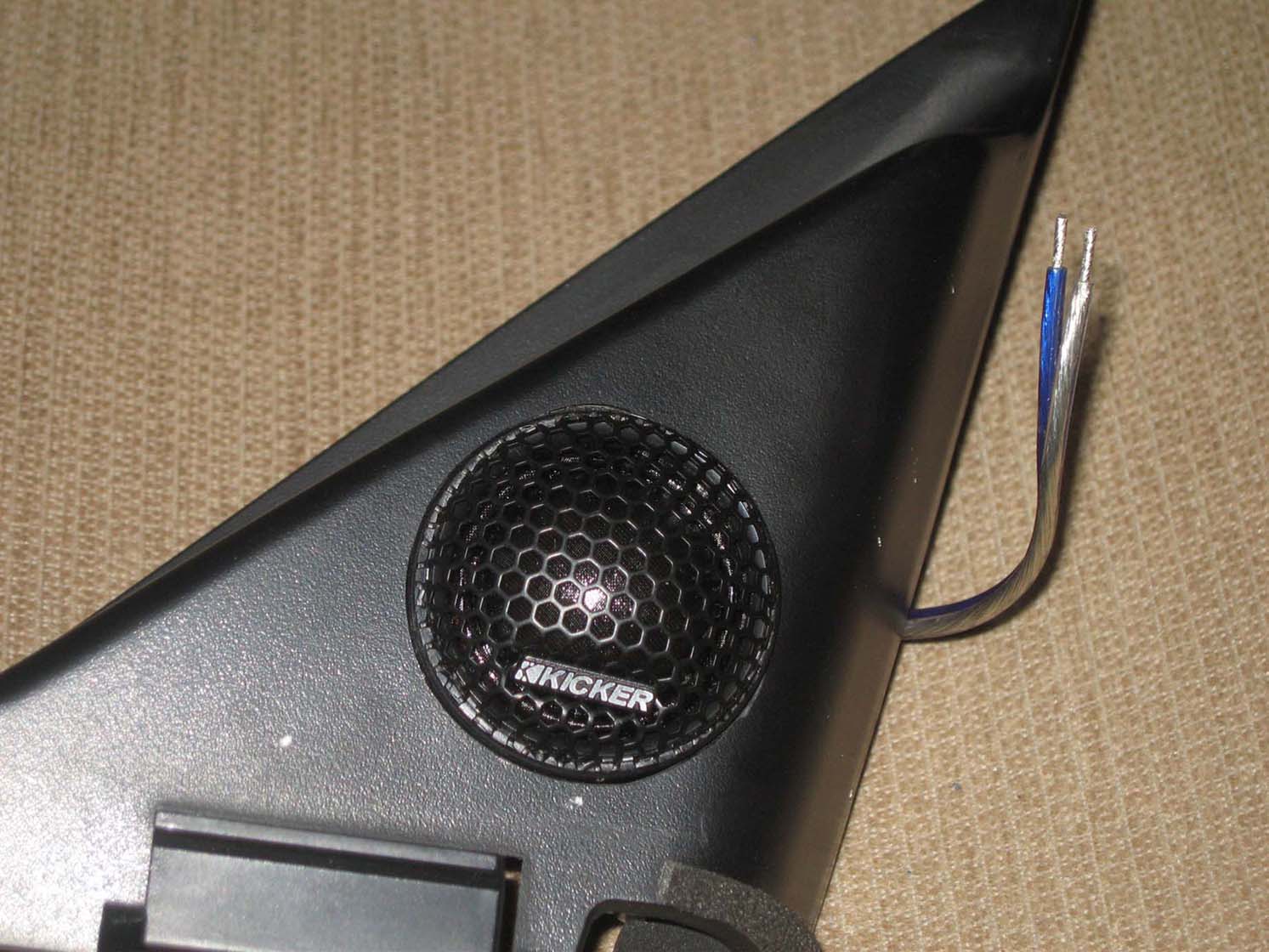

Damn kicker tweets are huge and the trim ring was to big for the stock tweeter surface area. Fear my dremmel skills

The pods look great! What prep/paint did you use to get the right texture?
the sail panel tweets look good too. The trim rings aren't even needed. Trim rings are for those that can't cut straight!

Prep with bondo and auto primer spray paint. Paint is krylon smooth texture black indoor outdoor. Has a picture of a lawn chair on it.
