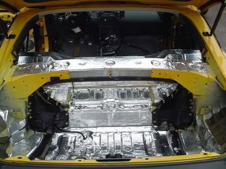

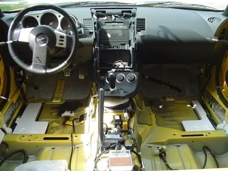

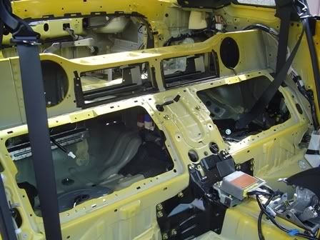

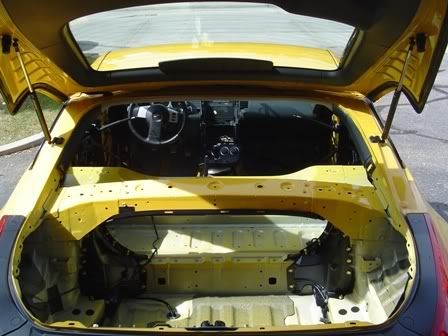

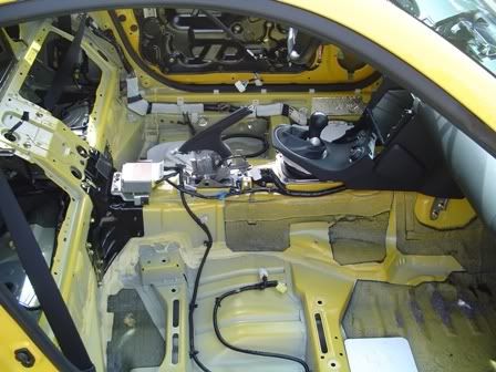

Here is the car with the interior completely removed for sound deadning.

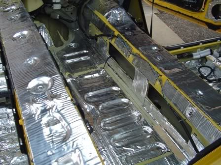

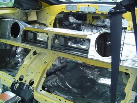

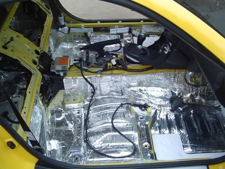

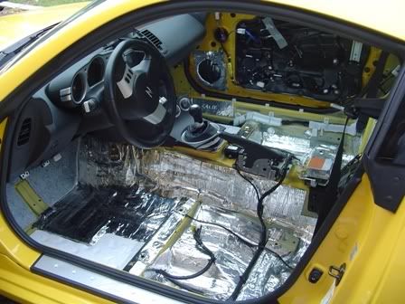

Now with 67sqft of Rammat installed.

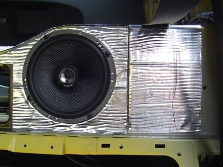

Rear Speakers installed.

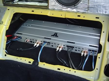

Amp installed in the enclosure where the old Bose subwoofer resided. Amp was a perfect fit and there is good ventilation here.

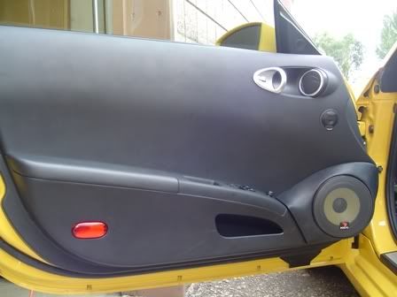

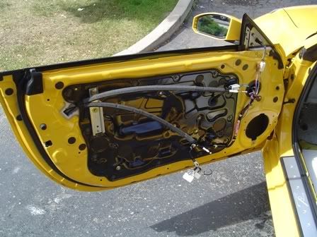

Door panels re-installed and Nazars pods bolted in. I didnt want tweeters in the stock sail panel location. I opted to have them closer to the midwoofer and lower in the door. I really like how the yellow Focal cones match the yellow car.

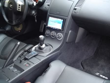

Now the Alpine head unit:

The focal Polykevlars are amazing! The midrange is very clear and the highs are intense. The drivers have very strong mid bass and I have them crossed over at 50Hz@24db. They are very fast and tight.
The rear speakers are just there for ambience and do not draw attention to themselves.

The sound deadning made a huge difference. The car is like a vault inside now. Road noise was virtually eliminated.

Did you have any problems with the metal door skins?
I've read here where people pulled off the metal inner door skins and then they had trouble with the windows. Because of these stories I stopped before pulling off the door skins and only got sound proofing behind the speakers and on the outside of the metal and inside of the plastic door skins.
I love the custom tweeter installation - very nice.

hey man you should be able to get the alpine to sit more flush in that dash. If you take it back out and drill new holes for the mounting it will sit back inthere flush.. If you search my posts you can see how far back mine sits.
That is good to know, I would like to sink that head in completely flush. Keith didn't think it would go any deeper but if you guys have done it, than I am sure as hell going to do it.

I thought I was the only guy running around with holes in my door from tweeter mounts. Mine are a bit lower and back from yours, but good choice. You should get the benefits of proximity to the mids, while maintaining a slightly raised soundstage

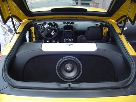

Just did a major sub upgrade!
I bought a custom made fiberglass enclosure for a single rear firing 12" sub. The box has 1.5 cuft and I bought a new JL Audio 12W3V3 subwoofer with grill to drop into it. Still waiting for the sub.
Here is a photo of the enclosure.
