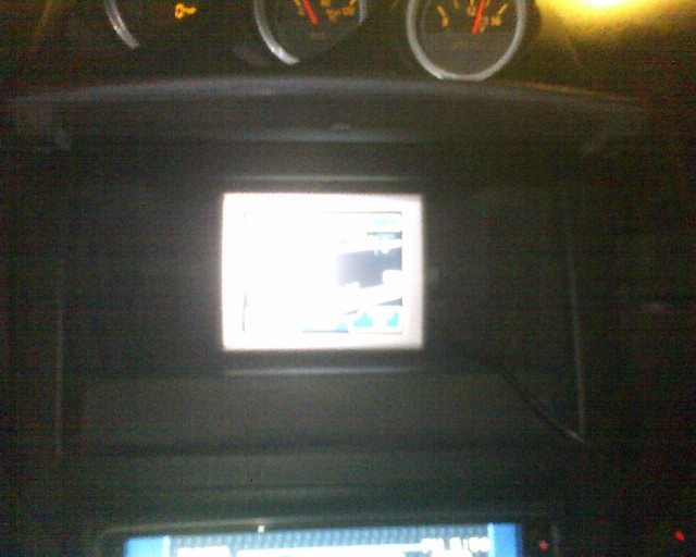

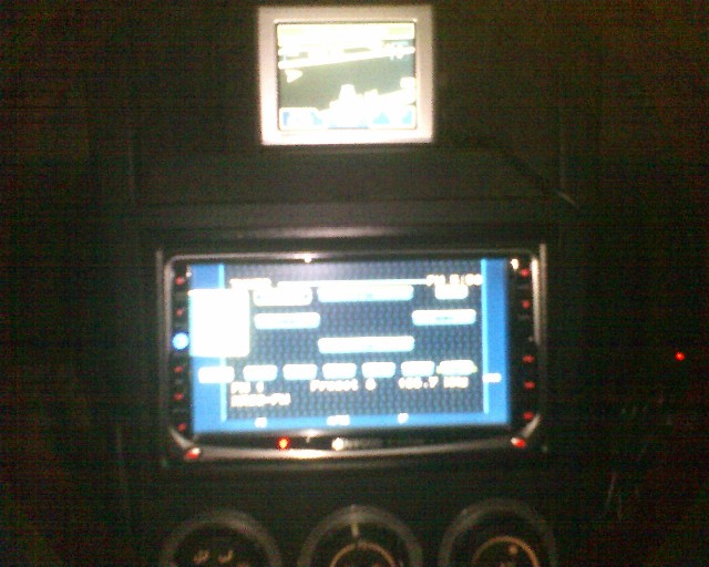

after much debating i decided to go with the garmin nuvi 350 instead of the garmin based kna-g510. the main reason was the portability, i can take it along when i drive my truck. there also seems to be more features in the nuvi. the signal strength is not an issue, its usually at full bars in the cubby. i just have to hardwire it. overall, i highly recommend it.
Attached Thumbnails Who has a pic of a portable GPS-NAV mounted in the cubby?-picture-010.jpg   Who has a pic of a portable GPS-NAV mounted in the cubby?-picture-011.jpg

That makes a lot of sense. You save big by using one unit in two vehicles, and now you can carry it with you when you are on foot. If you take the truck off-road, it’s handy to mark your location, go hike, hunt, or whatever, and then find the truck in the dark. Same goes when you are in a strange city or location with the Z, leave the car but take the GPS, and find your way back.
Another advantage to this configuration is putting the GPS screen in the upper/forward cubby. My feeling is that is where your GPS screen should be because it is closer to the line of sight from the driver’s eyes to road. It is certainly better than looking a little down to the double DIN location. The single DIN navigation units with flip-up screens get the sight line pretty good as well.
I like the 7” screen (bigger and easier to read quickly), and want this in the upper/forward cubby for the reasons I mention above. The problem is fitting any of the available monitors with touch-screen function in this location (the Z’s upper/forward cubby). The touch-screen monitors all have controls along the bottom so you would probably need to either make a custom bottom piece to fit the cubby, or do some very careful work with a dremel along with some custom trim pieces. I have seen an Alpine 6.5” touch-screen mounted in the upper/forward cubby. It was OK, but not as neat an install as Paul did with the Farenheit.
…Any particular reason you went with the Nuvi 350 instead of the 660? --Spike
