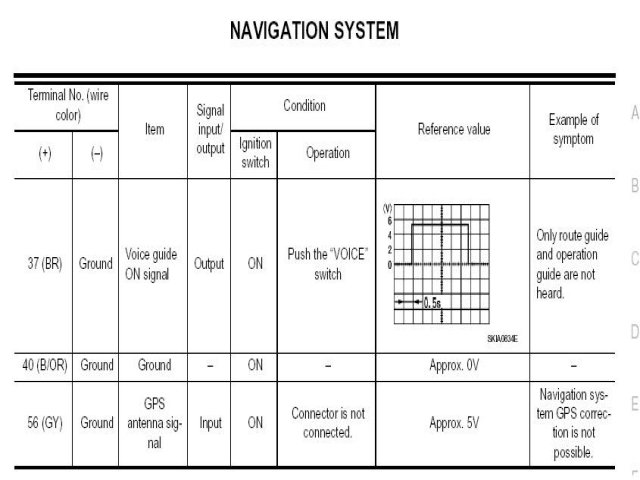

I plan to have a Blaupunkt HU installed to replace the Clarion unit. The installer's only concern is around the Voice override of the sound system. He's asked for a schematic of the system. Does anyone have a service manual showing the wiring schematic. It would be greatly appreciated. I did find this posted by someone but I'm not sure it will help the installer.
Attached Thumbnails Help with voice guidance and new HU-reference-voltage.jpg
