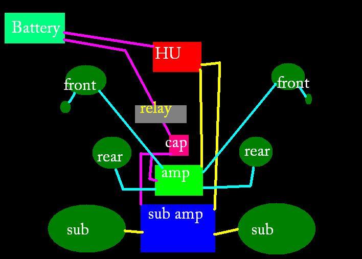

instead of the power cable going to your cap first it's going to go to the relay and from there to the cap.....so it won't have to be under the hood.

here is the wiring diagram of how a complete setup system should look like....sorry for the bad drawing.
