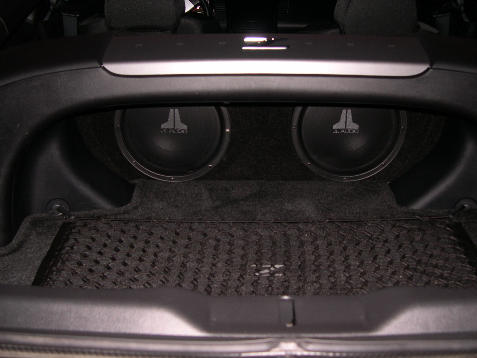

That is sick! I am too lazy to go out and lok, but it there room to do that on the otherside for a matched pair? I hate the loss of trunk depth from my box mounted in front of the strut bar.

Originally Posted by chefrey
i have found this works great with a 10w6v2 a 10w7 is to deep to use in the space
everyone in know that has tried this has failed....how did you make it so there are no rattles? i am not looking for ground shattering bass...but i do want something that sounds pretty good, much better than stock.
a local shop says they can/have made a small box that runs a Memphis shallow sub and it sounds great....also alot less than the 3 bills it costs for the FG one.
Old Sep 7, 2007 | 05:11 PM
chefrey's Avatar
chefrey
iTrader: (20)
Posts: 365
From: delaware
mine sounds great with no rattles. it takes a lot of dyno mat (used a whole trunk kit), about 7 hours of work, and paying close attention to what you are doing. as long as you completely seel the area off and dyno mat the ring the sub is mounted on it works great. i have a jlw6v2 with about 600 watts going to it and has held up sounding good for over 7 months now.
