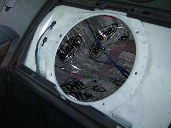

If you want to put one behind the seat you need to get in there and really seal it up. Dynamat should go around most of it and you can use some kind of sealant on the corners to make sure it is in there real good. Once you do that you might put something like a pillow in there to take up some of the space. The space is really large so don't worry about having to use a small sub. The thing you want to do is look for subs that specifically say that will work with free air enclosures.

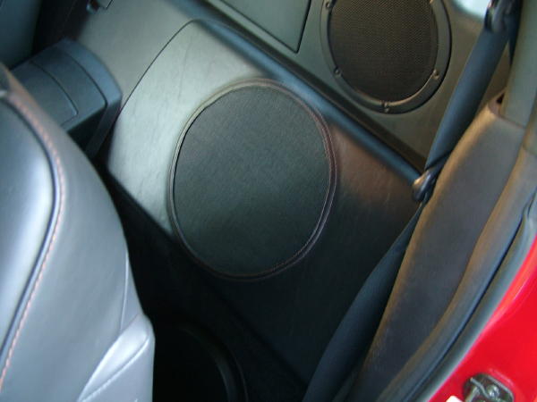

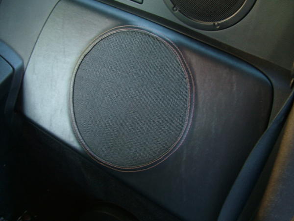

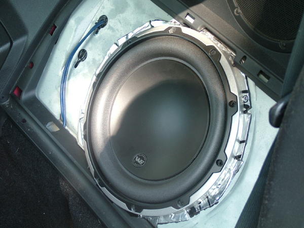

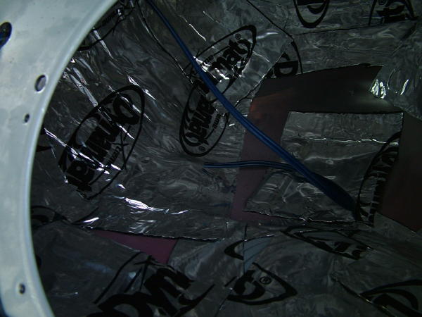

Old Sep 5, 2007 | 08:24 PM
chefrey's Avatar
chefrey
iTrader: (20)
Posts: 365
From: delaware
i have found this works great with a 10w6v2 a 10w7 is to deep to use in the space
