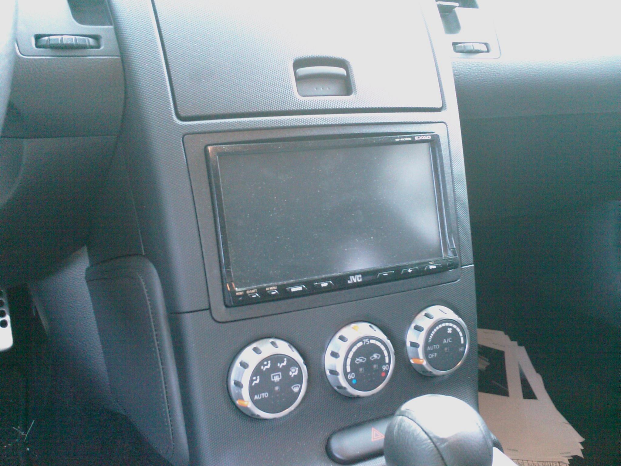

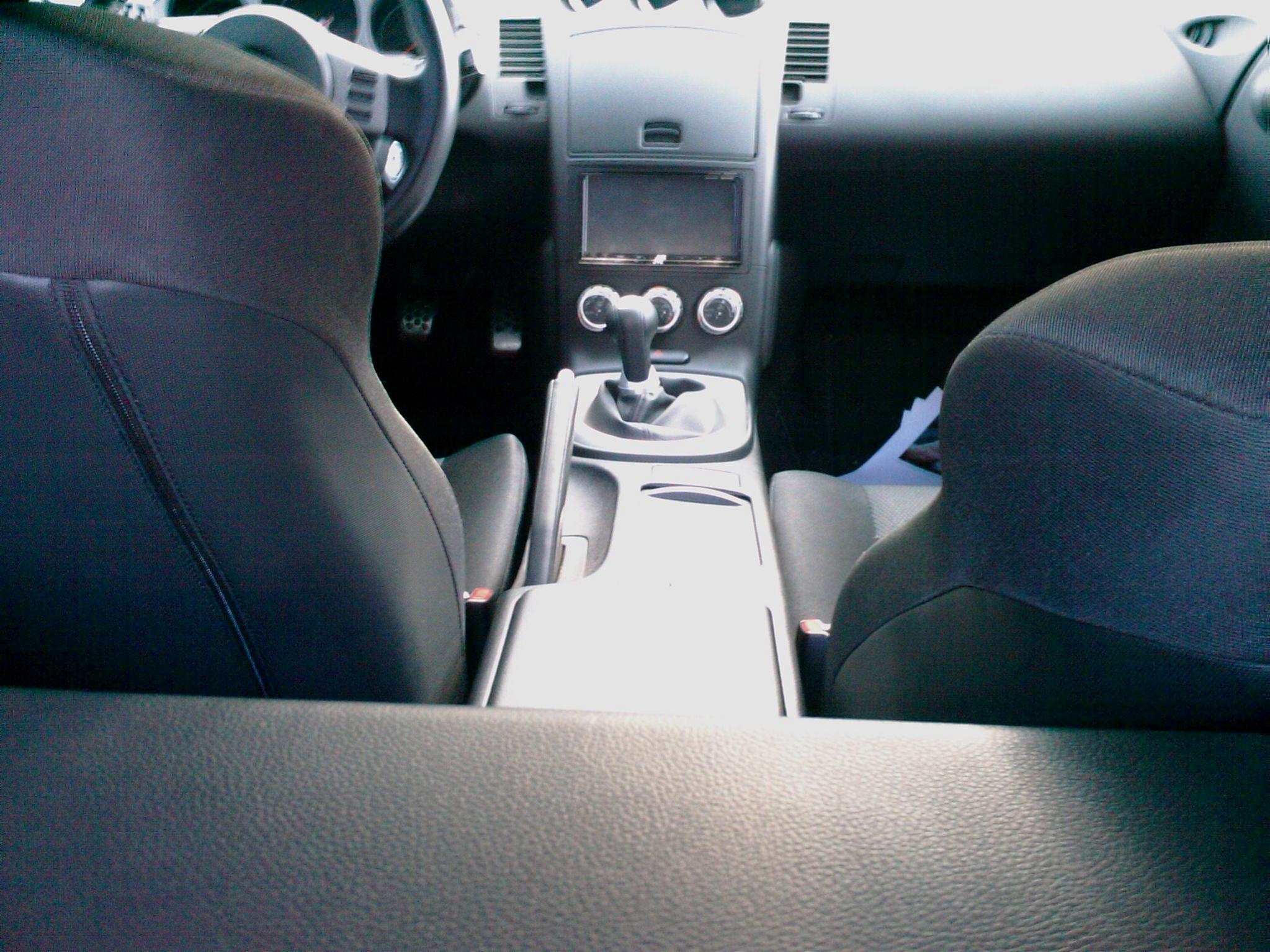

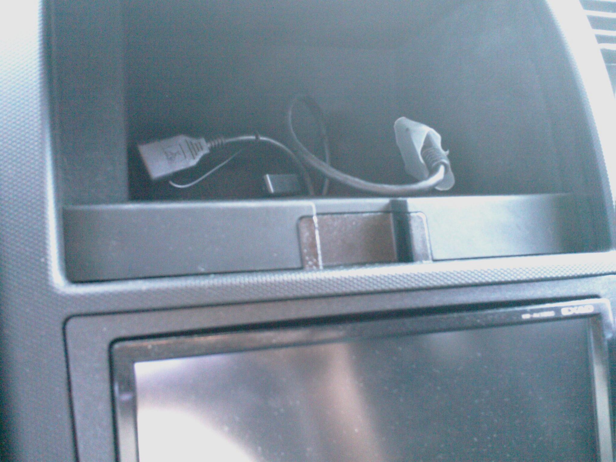

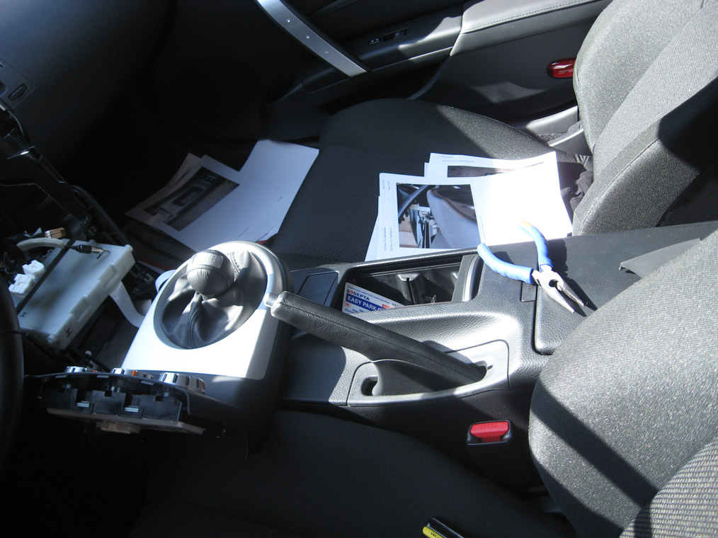

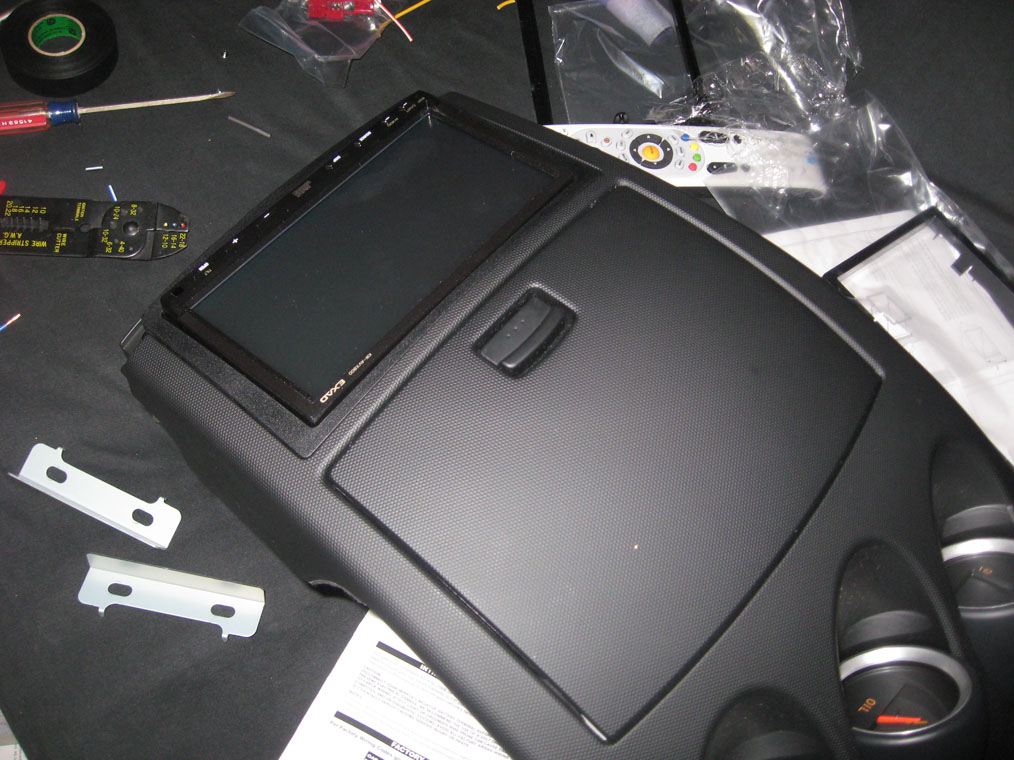

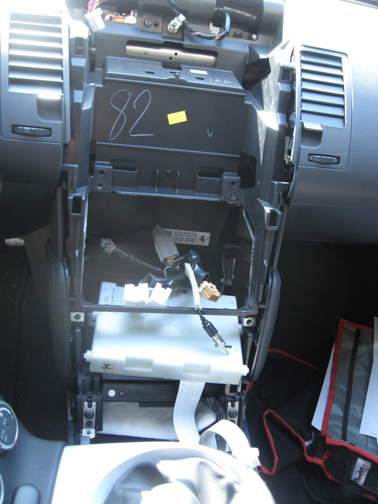

I finally did the head unit, I have to do the speakers still. The gloves are a good idea, I got myself really good when i pulled out the antenna wire from the stock head unit. The whole thing took us about 9 hours ... not so much because we were clueless, but more so because there isnt alot of space to work with and we had to get creative when fitting it all in. I put in a JVC-AVX800 head unit, the JVC Ipod interface and the Swi-Jack so I could retain use of my steering wheel remote. I'll post pictures
Attached Thumbnails Help Installing Head unit and speakers on a 07-img_0915.jpg   Help Installing Head unit and speakers on a 07-img_0913.jpg   Help Installing Head unit and speakers on a 07-img_0914.jpg   Help Installing Head unit and speakers on a 07-img_0917.jpg   Help Installing Head unit and speakers on a 07-img_0916.jpg

Default Pics of head unit installed
