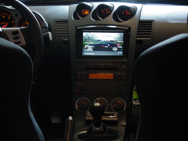

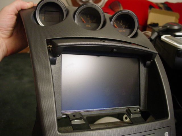

Alphared's Eclipse program is VERY nice but it is for brightness, not glare. The Xenarc screen has a thin plastic screen protector that sits on top of the screen. If you remove that, it should solve your glare problem. Here is how mine looks without it and I have no problems at all.

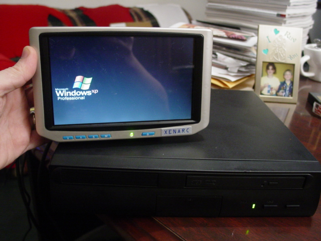

Here is what it looks like "stock" before you remove it from it's case with the plastic cover on:

In the car:
