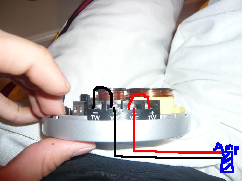

Originally Posted by lukep90
what would happen if i spliced both wires into 2 ends? there is one diagram that shows one wire split into two going into the input.
That is in effect doing the same thing as I described using the short pieces of speaker wire. Like attached (pardon my crude paint skills).

i ended up runing the jumper wires. works great! now only if my door panel would go back on...
